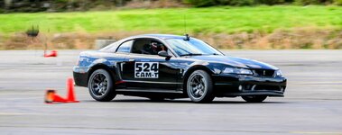

Complete Full Tilt Boogie Racing IRS setup. Maximum Motorsports K-member and complete front end parts. Koni DA front, SA rear coilovers. 275 square setup. Apex EC-7 9.5" wheels. Stiffler frame rail connectors. Torsen T2-R Differential with 3.73 gear set.
rotating assembly is rated to 1000hp. Car made 320 hp and 370 ft/lbs at the tires.
Mods - Interior
Corbeau FX1 seats, Rear seat delete
Background & Plans
I only use the car for autocross. I'd like to fit 315's square sometime. Better dampers and possibly a SLA front end setup would be nice if I had the budget. Car is very competitive locally in CAM.
