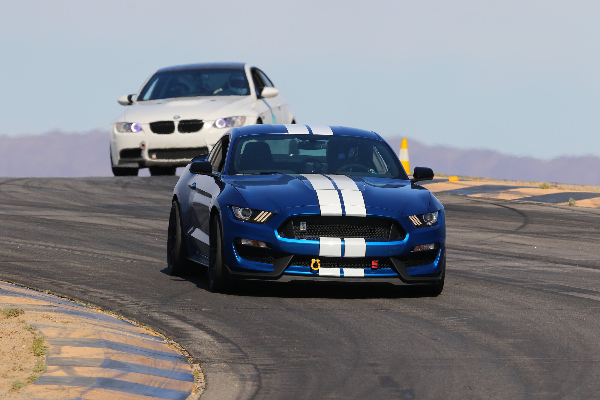

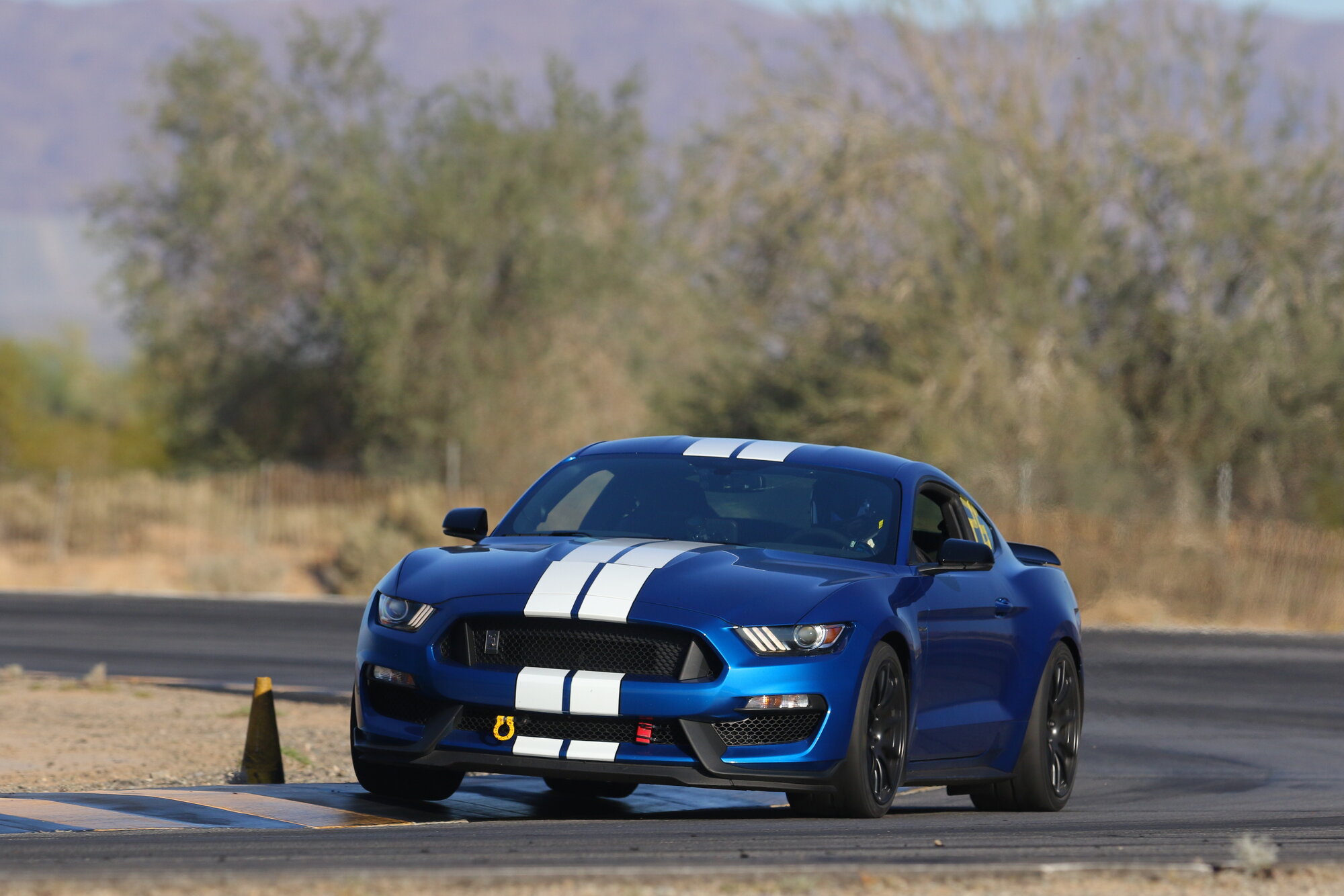

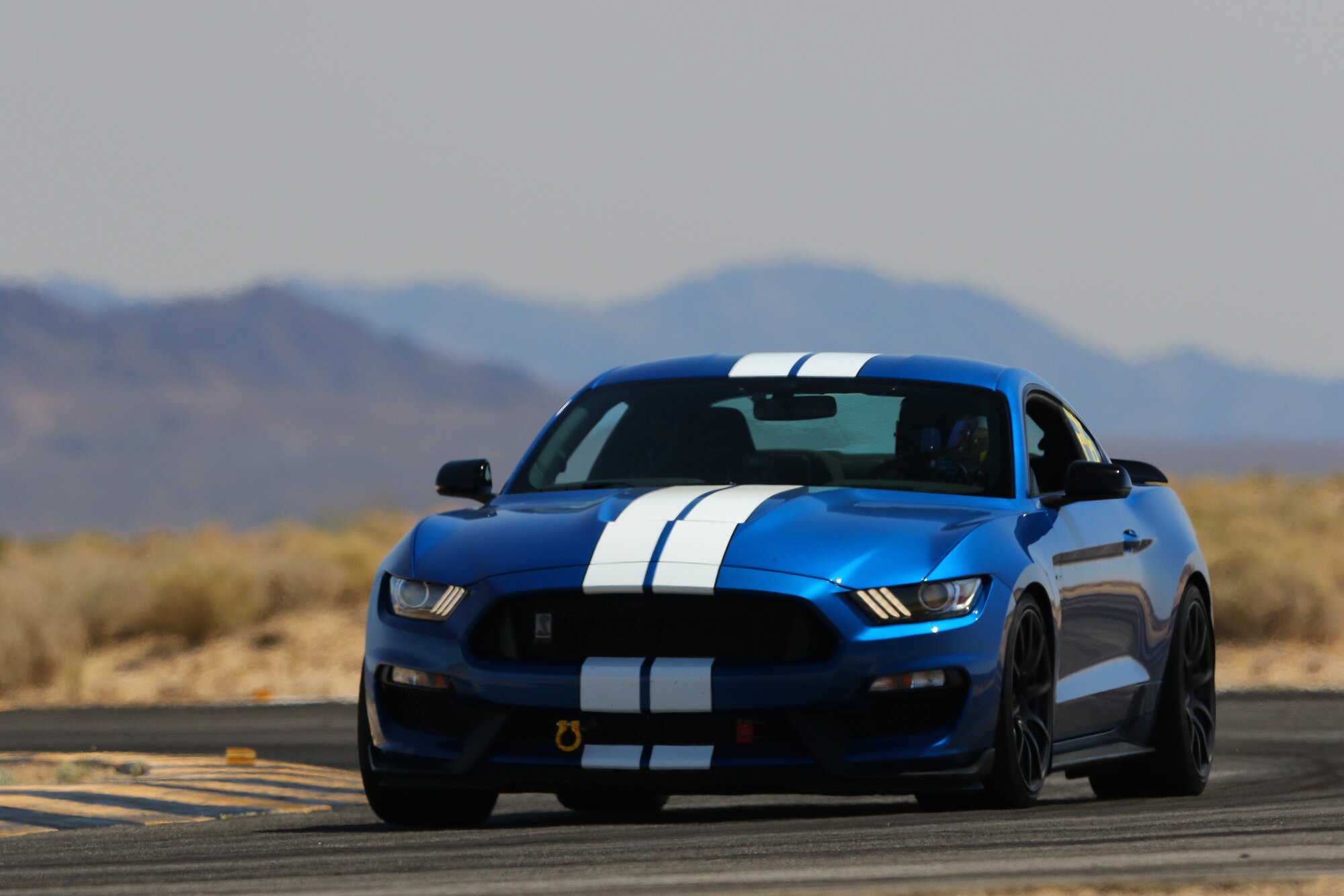

I currently drive with NASA AZ in HPDE4. I plan to stick with HPDE and not move into TT, but time will tell. I run about 5 weekends a year around the Phoenix area.
Current best lap times:
AMP CW - 1:49.976
AMP CCW - 1:48.622
WHP East - 1:01.13
WHP West CW - 1:10.167
WHP West CCW - 1:09.788
Inde CW Config 4 - 1:43.792
Inde CW Config 5 - 1:58.583
Current list of mods (12/30/2021):
Suspension:
Ford Performance springs and sway bars
Vorshlag camber plates - -1.95 F and -.9 rear (need more camber)
Brakes:
Cobalt Friction XR1/XR3
Castrol SRF brake fluid
Caliperfexion stud kit
Verus Engineering Brake Cooling Duct Kit
Wheels and Tires:
Apex SM-10 19x11 et52 square
OPMustang extended studs
OPMustang 25mm spacers
Goodyear Eagle F1 Supercar 3 - 305/30/19
Engine:
Lethal Performance resonator delete
Interior/Safety:
Schroth Quick Fit Pro
Schroth SHR Flex
Future plans:
Run the current setup for the foreseeable future and just build up more seat time
