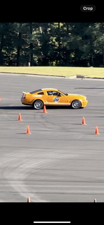

Sorry I missed this thread. You will be fine on RE71's and will want at least 3.5 camber. Photo is my car with 295's and 4.1 static camber. Seemed to be decently competitive at Nat's.

Nice looking car. I love the stance
