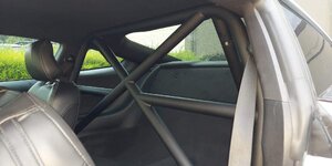

Might need a bit of a rethink about the ability to remove the cage and use the back seat. The rear bars go through where the seat backs would be. Its also not a 5 minute job. Try a few hours after the initial install has been done. Its a once in it stays in unless you need access to the fuel pump hanger of another hidden item. Consider it a 2 seater.
Nice looking seats, hadn't seen those OMP ones before. Be aware you also have a lot of electrics from the origional seats to consider and seat belt mounts as the stalk attaches to the seat frame, not the chassis.

BTW just out of curiosity, what roll bar do you have in that picture?
Edit: did a bit of perusing through other parts of TMO, it seems something like this would be a way to overcome the seat belt buckle mount stalk issue.
