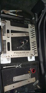

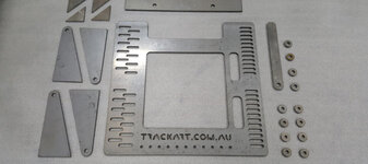

Or if you are silly like me and on the other side of the world. You spend many hours getting it how you want by doing it yourself, with the help of a fabrication kit.
