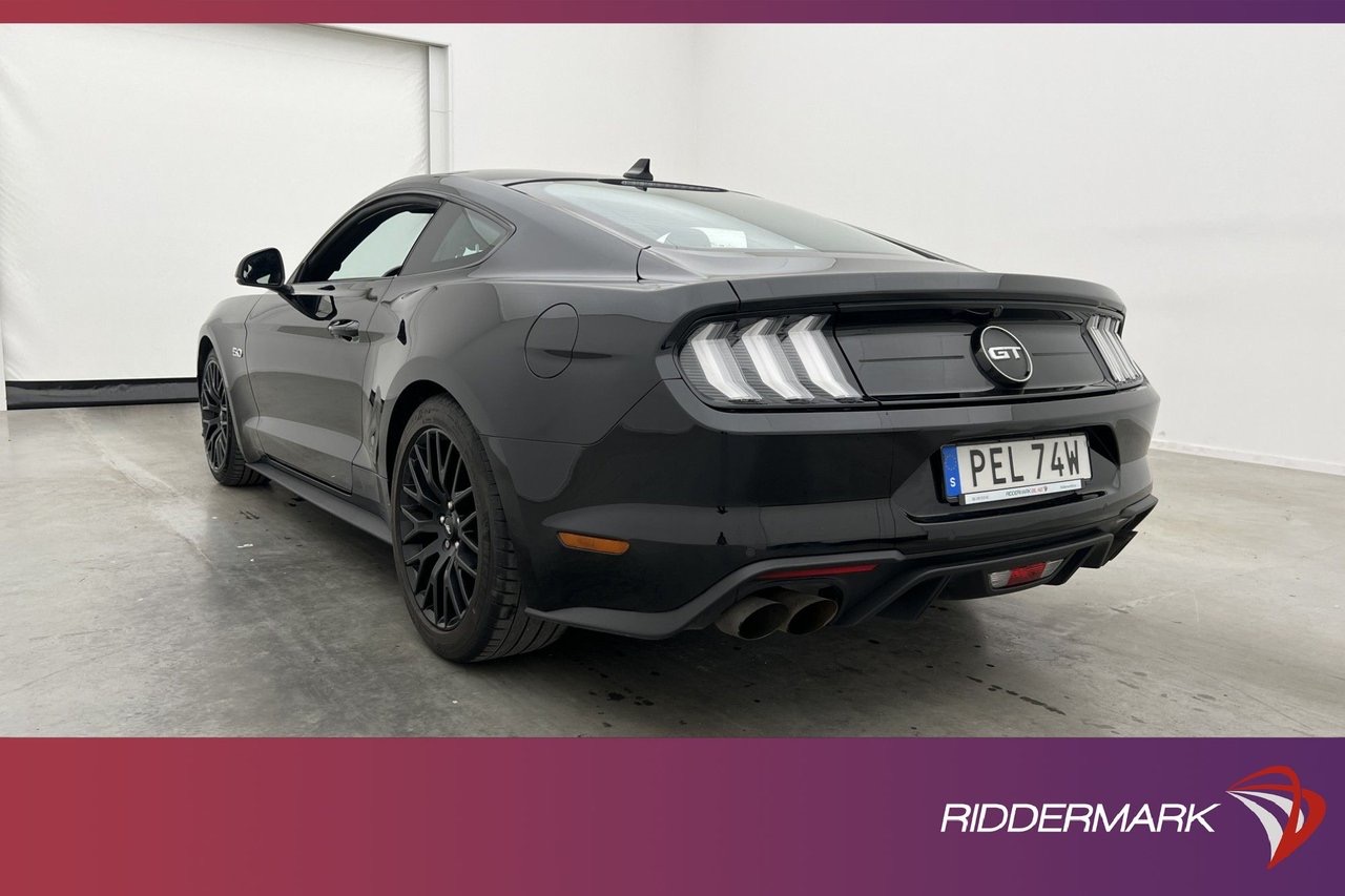

A couple of months back I bought a S550 Mustang GT 2020 (10R80).
Its my first Mustang and actually my first American car but Im in the start process of trying to build it too a quite fast but versatile track car..
As a background Im a real rookie to Mustangs but been racing(Circuit and TimeAttack) and building a Porsche before on a quite high level.
The thing is that in the US the Mustangs are super common but over here in Sweden the are only known for running of the road all the time due to really bad handling... ;-) That was quite impelling to me since ive been reading up on them a bit and realize they we have some hidden potential here to scare and potentially surprise some Porsches at the track.. I set my goal pretty high and the idea is to be able match a Porsche 991Gt3RS at the track... I think going after a 992 would be to much of a ask but a 991 should potentially be doable...
Any way im right now in the process trying to figure out the recipe for doing it but the issue with mustangs is not that is hard to find parts, its the other way around with to many options!! ;-) ;-)
Ive been "stalking" threads from FlyHalf and others on the forum but not written anything since im a rookie with not much to add to the discussion but eager to learn a bit more and think I picked up a little from your great and fast builds on the forum, especially FlyHalf..
The recipe in my build right now look like below and I would be super grateful for some suggestions, objections, tips and tricks!
Mustang GT 2020 PP2 EU model

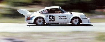

When I started racing Porsche 15 years ago everyone told me to get a at that time a 996 GT3 that was suppose to be the superior car to the 996Turbo at the track...
But I had a Porsche 944 Turbocup earlier and knew the benfit of turbo and midrange power.. I Bought a crashed 996Turbo and rebuilt it to a CUP replica except for the power train. A couple of years later I was 10 seconds ahead compared to the GT3:s...
You would be better going 305 square on 19s.
For one thing, other than used race slicks on 18s which can be hard to get, there are lots of 305/19 tires around.
Mustangs have lots of rear grip, the problem is to get them to stop pushing. All that weight up front puts a lot of extra load on the front tires. Going with wider rears will exacerbate the problem.
I think I have experienced oversteer with a Mustang 5 or 6 times in 9 years of track days, meanwhile, I experience push on almost every lap.
My DH has 305/315s. That is going to be replaced by 305s square for track days, that's the secret sauce to make a Mustang handle.
Race cars are a total different story.
That's just the way it is.
Some years later I rebuilt it again to a RSR replica and I was runner up in the TimeAttack Nordics Championship for two years and then won the Championship for two years before I retired the car back in 2017 from Racing... We built it back to the streets and made it roadlegal once again with Idea of having it as weekend track car... But its to extreme and the level of fun was not there anymore, escpeciallly since it will always be slower then it was in its prime!
