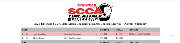

For the archives. Completed SCCA Targa this past weekend. Set a new PB at Cresson 1.7 CCW, 1.27.000 during that event. Turned laps at Hallet, Hedge Hollow, and then Eagle Canyon. Then proceeded directly to Time Trials at Eagle Canyon. Pulled off the win and set the new (probably only) Club Spec Mustang lap record at Eagle Canyon. I firmly believe I will knock that down into a 2.16 or a 2.15 with more seat time; only the second time for me at this track, first in this chassis.
