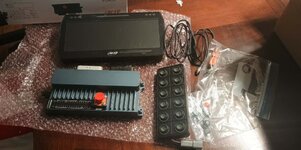

Decided to pick up an aim pdm32 after finding a great deal on a never installed pdm32 and 10 inch dash. I am keeping the factory dash for now, but need telemetry. Picked aim as their data is pretty well accepted without going the much more expensive routes. Don’t need the pdm but I feel the value in the pdms vs the standalone logging dashes justifies going with a pdm over their dashes.
Only thing I will not have is a radio so decided to use that space for the aim dash.

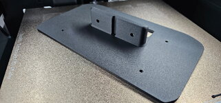

Going to 3d print the mounting bracket.
Final is printed out of ASA Carbon Fiber. I will glue it to the front bezel and have some mounting hardware for the back panel of the bezel.
