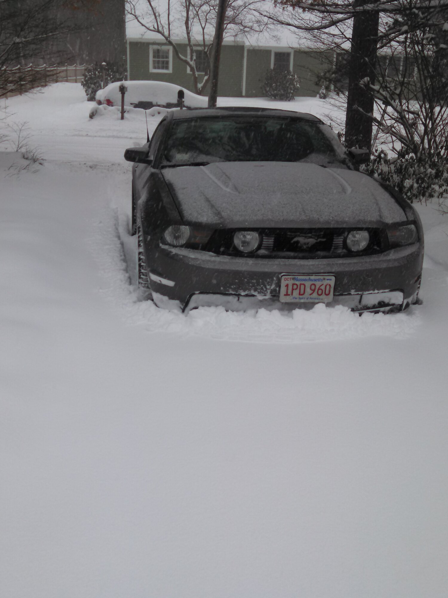

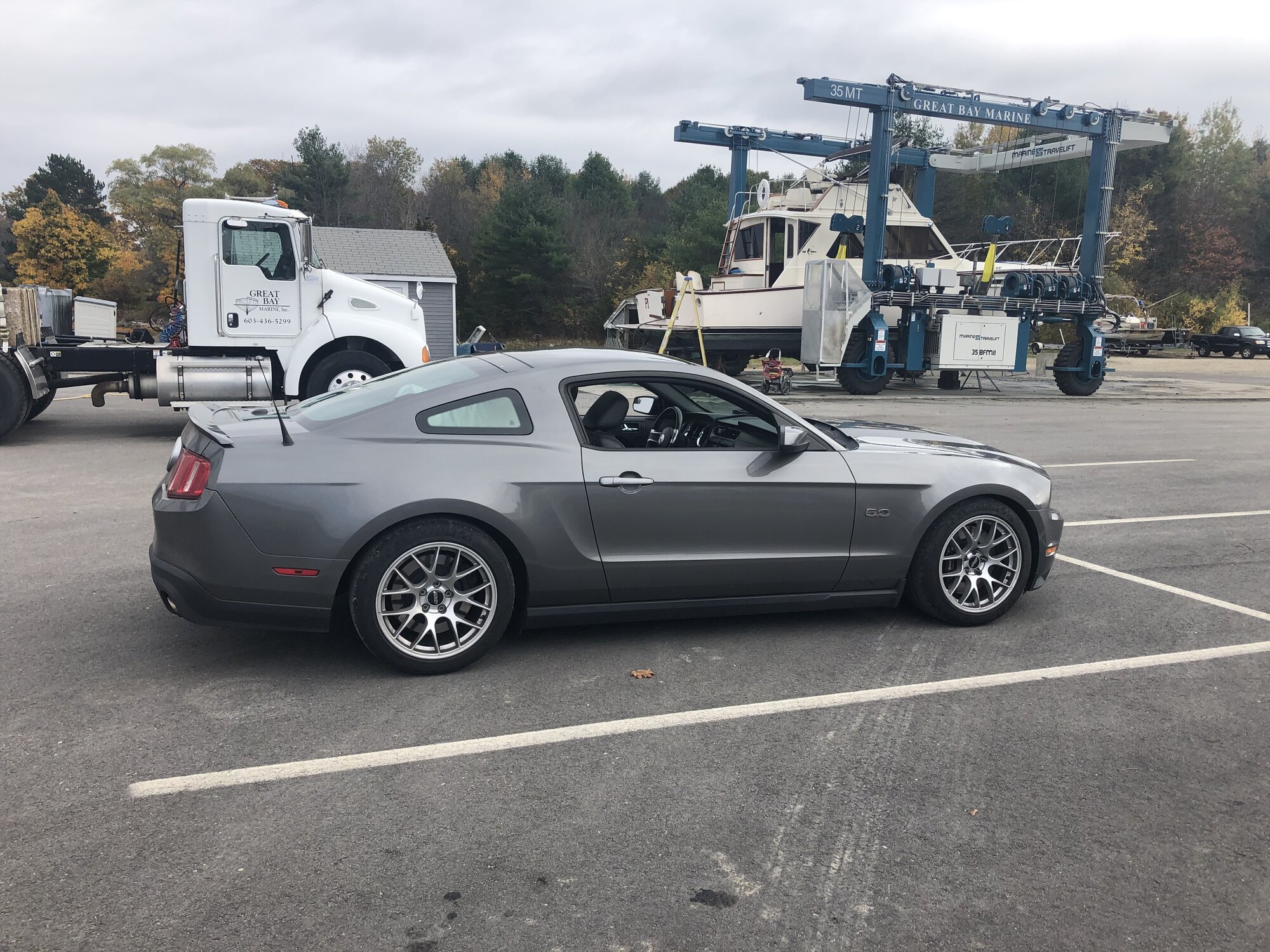

Background & Plans

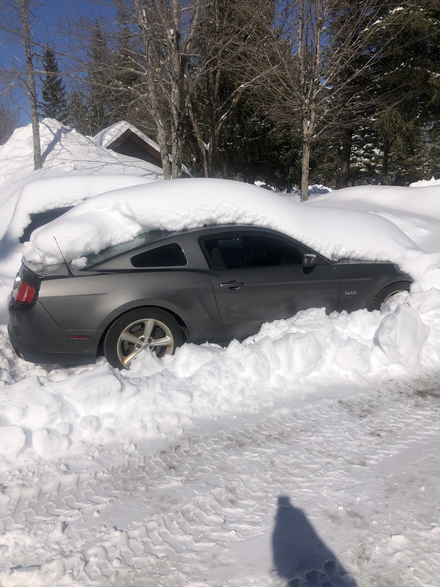

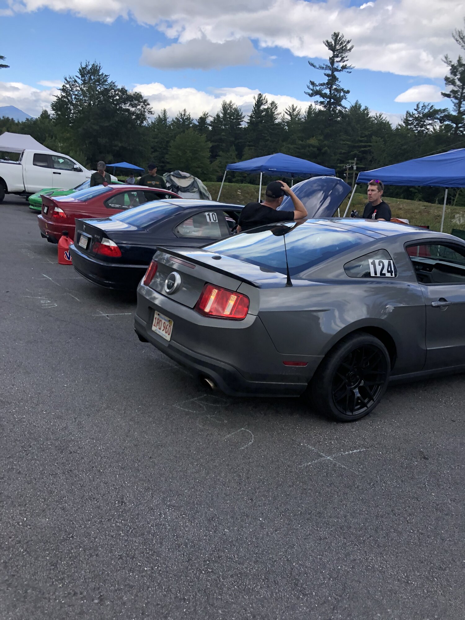

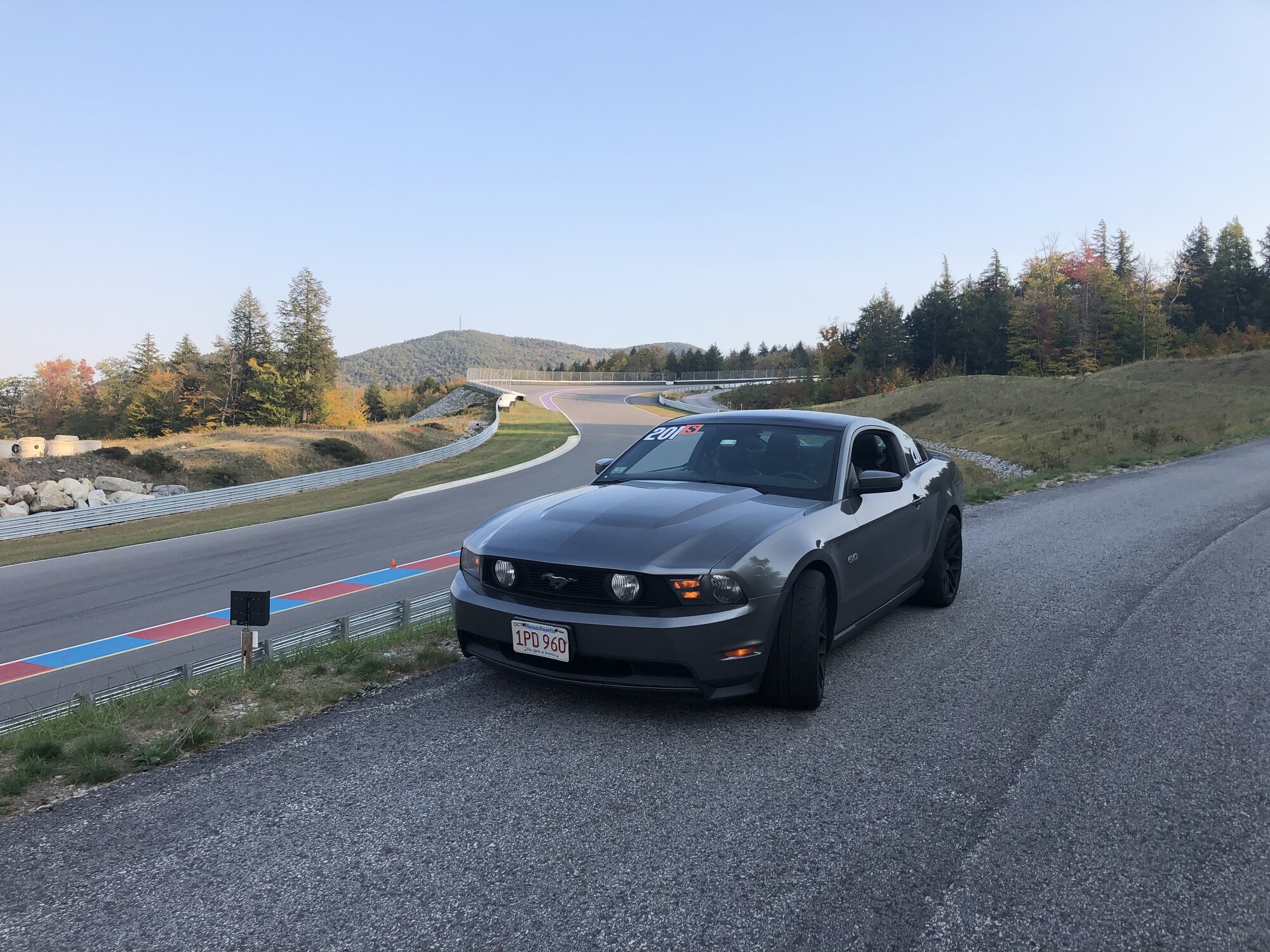

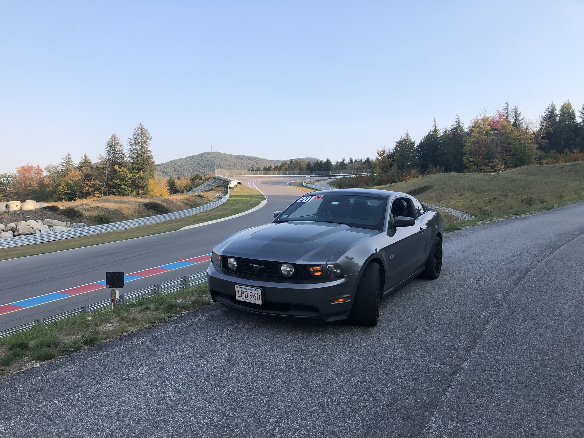

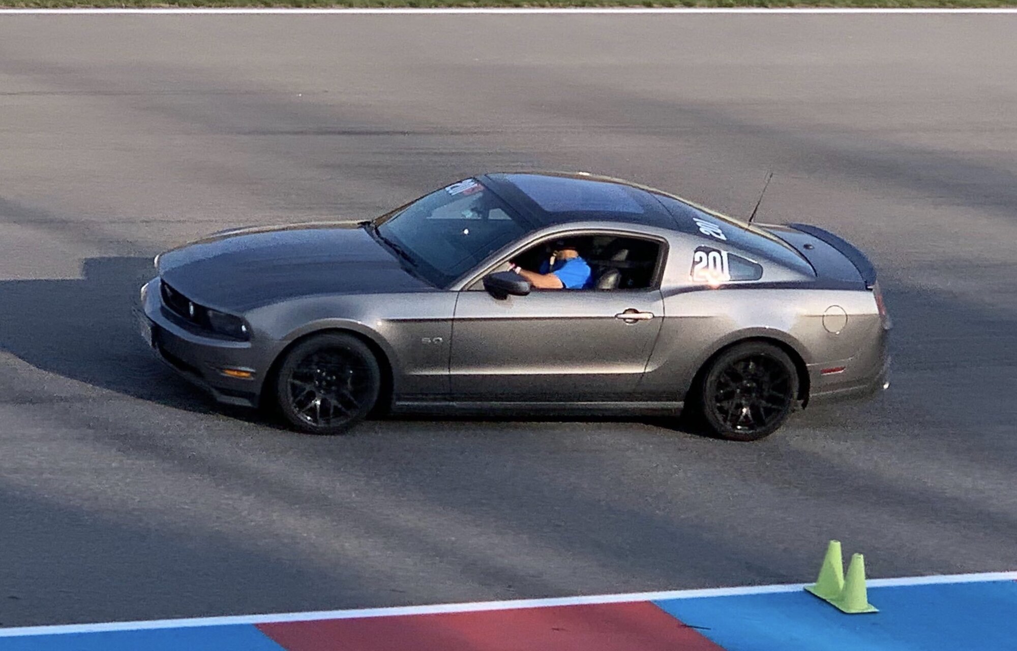

First Mustang, bought 10 years ago with 25,000 miles, now at 197,000 miles. Has been a great do everything car, commuter, fun car, ski car, and track/HPDE. I’ve had a blast, taught kids to drive stick, and learned a ton about track driving with this car.
