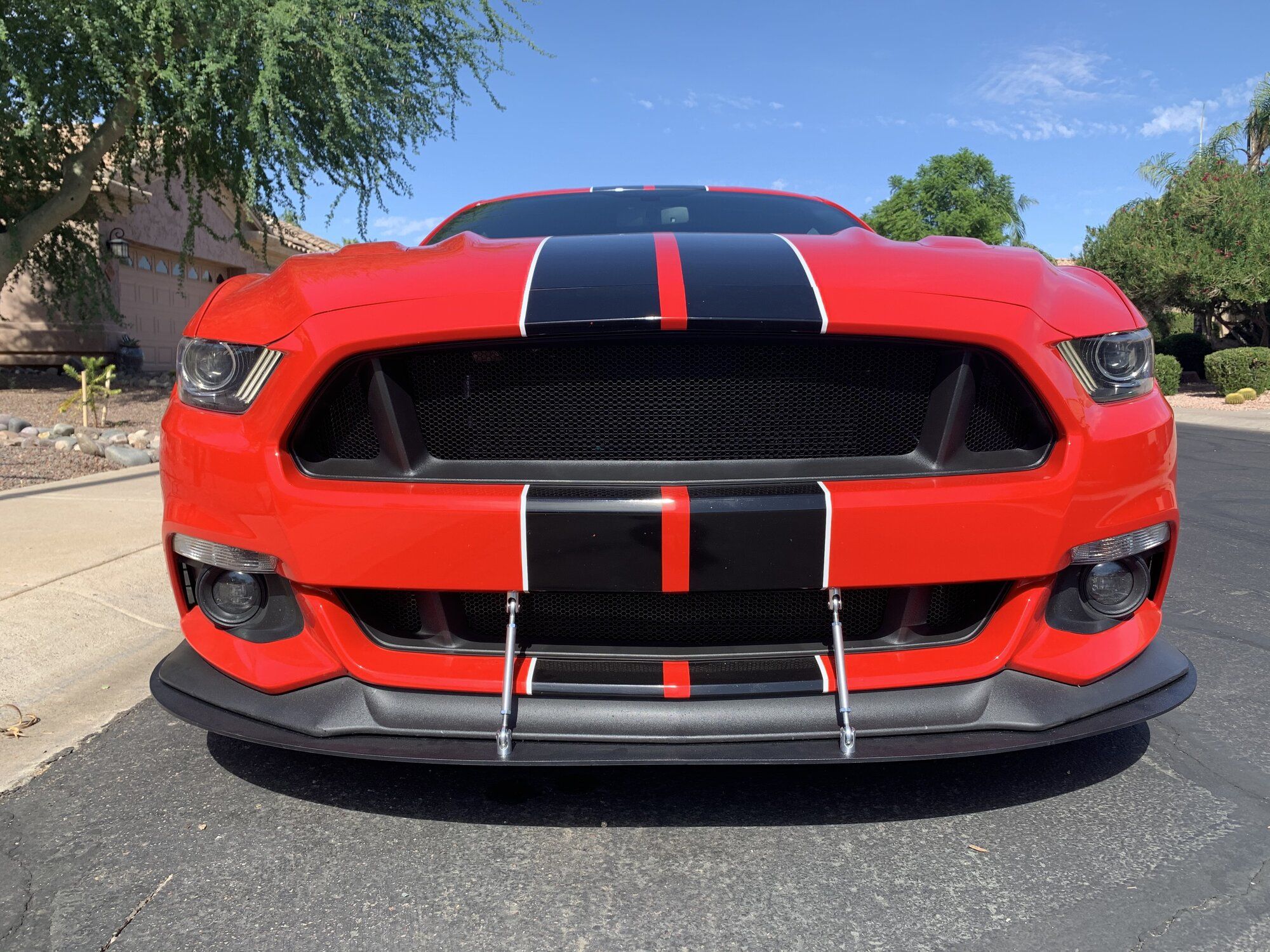

Mods - Exterior
Steeda S550 Mustang Upper & Lower Grille Delete Kit
Aluminum mesh grill inserts
AJ Hartman Apex 8 swan neck wing
Steeda S550 Mustang Front Splitter
