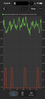

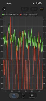

well found my issue for the intermittent Service Charging System Now....with only p0620 and p065B codes that also came and went and no other codes. So I hooked up ODB2 scanner and looked at the Gen Com% and Gen Mon% graphed. Seems an erratic Gen Com% is a bad thing. It should be staggered peak plateau as seen when scanning old unit with no light vs new unit no light on. Just incase someone else has similar issue.
