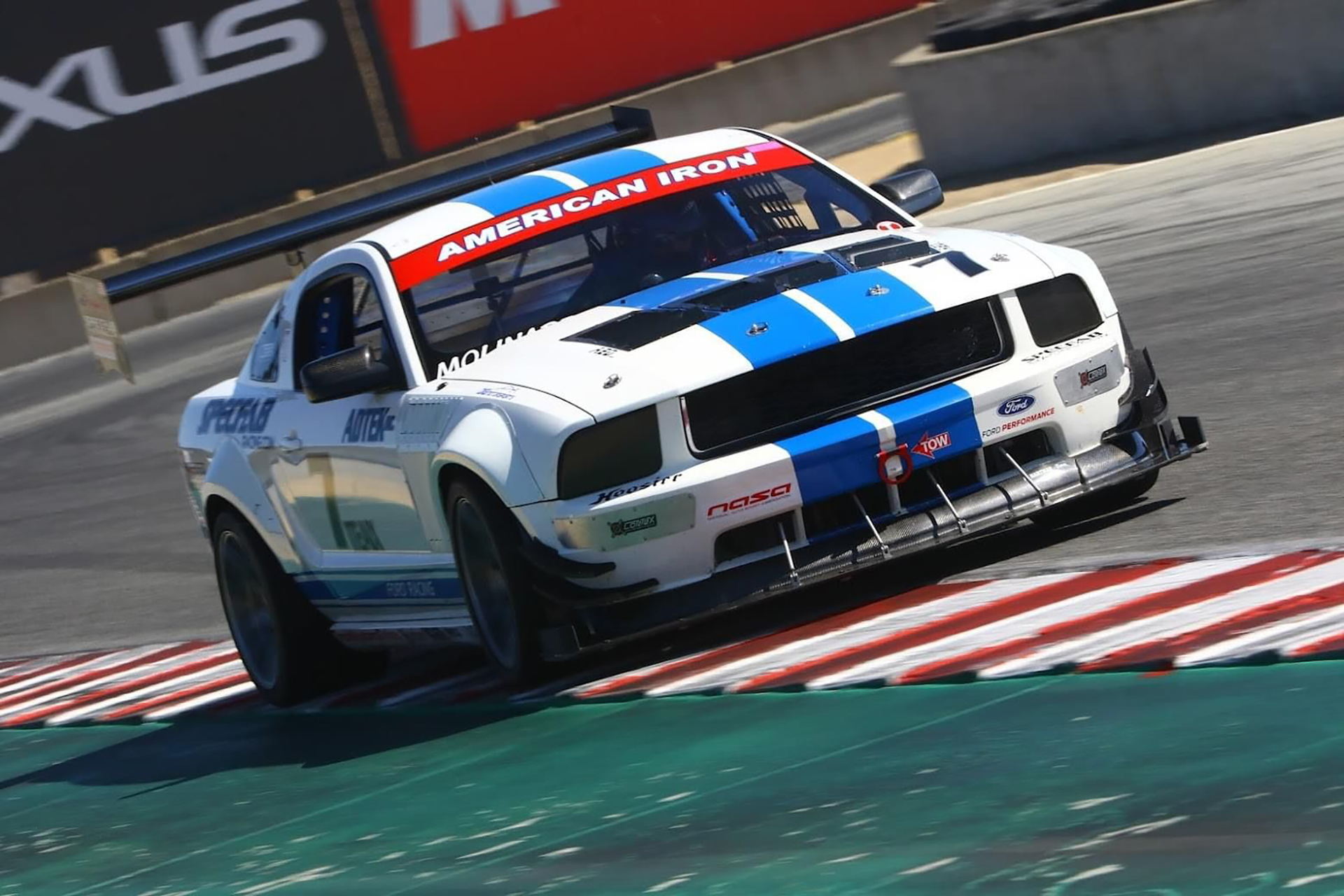

Oil is typically 190-200ish and water is 200-210ish.
E85 helps a bunch but I have done a number of things to help with cooling.
Big oil cooler, custom 3 pass/3 row aluminum radiator, (water crosses core 3 times on its way through) 32 psi radiator cap, a bleed hose from the water neck to the recovery tank (to purge bubbles), bleed hose from top of radiator to recovery tank (again, to purge bubbles) electric water pump, no thermostat (custom hose routing) balance hoses in the heads, 16 quart oil pan, custom made hood louvers and really good rad/oil cooler ducting. I had no idea how much cooling the coyote swap was going to need so I covered all my bases and it’s worked flawlessly. I’m making 508 RWHP and racing wheel to wheel. It’s all laid out in the build thread…..
