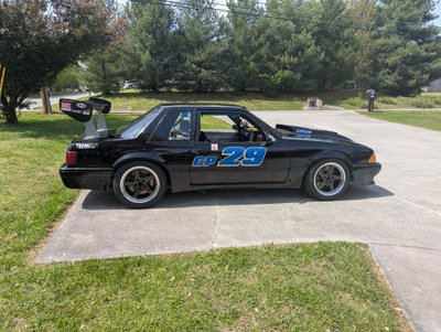

On the flip side the amount of money you plan to spend you can easily get a used caged Mustang of some sort and end up with two Ponies in your corral. Depending on what your end goal is ( Autocross, Time Trials, Road Race ) , 40K would definitely open up alot of options.
There are a bunch of us on here who built our own Racecars and then the next time around we bought one already done, since even then there are things that will need updating and modified. It is a cheaper way to go by a long shot.

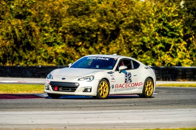

If you'd then also like to do some track stuff, there are so many great "track prepped" cars out there selling for what you want to put into parts for this one! That's true of any motorsport. I see log-booked rally cars that are class ready for less than it takes to build come up for sale, regularly. For grip stuff, here's a foxbody local to me that is a LOT of car, especially for the $25k they're asking.
Doing what I'm doing and "building a track car" is honestly the fools errand if it's not for a very specific reason. I'm not trying to push you away from a classic car as a track car, they're actually surprisingly "not bad". However, I'd get some seat time in a real, track-ready car before thinking you need a lot of these other items to go fast. Then at that point, something like a S550 mustang or a C6/C7 corvette (basphemous on a mustang board, i know) would be a much better "big power, go fast" car to look at for a start.

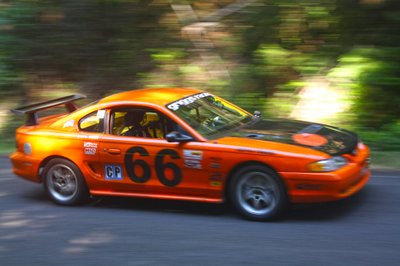

Learn on a disposable, already built racecar. Not on a 69 Mach 1.

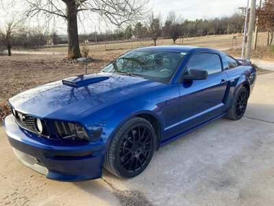

I'd consider a salv title newer GT500. Don't even have to change from stock brake pads. 85% in that car
is pretty fast, and not really much danger of crashing. And they even ride pretty good on the street....
(way better than I was expecting).
