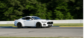

Finally went to my first track day at Atlanta Motorsports Park. Car was great and handled very good although still lacks mid corner feel. Hard to tell when the tires are all loaded up through the corners but thats probably due to the EPS. Also need to get better shocks as I find it to be a little bouncy on the more uneven parts of the track (mainly through turn 15 & 16). Other than that I had a great time and am looking forward for more track days.
Upcoming mods (based off of this track day):
-Better seats (prefer to not get fixed back)
-Better shocks (probably FP track shocks)
-Hankook Ventus RS4
