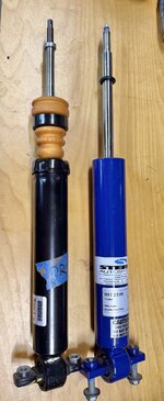

What rear shocks are on your car? The shock at full extension determines the droop, so aftermarket shocks that are a bit longer than OEM might allow the suspension to swing lower causing the interference. To be clear, I'm grasping at straws now.
Steeda single adjustables. They actually look a smidge shorter than stock were the mount sits.
And that's what grasping at straws looks like in real life. I couldn't imagine an all-Steeda setup having a problem like this, but there we are. Something's different, but nothing's actually wrong.
