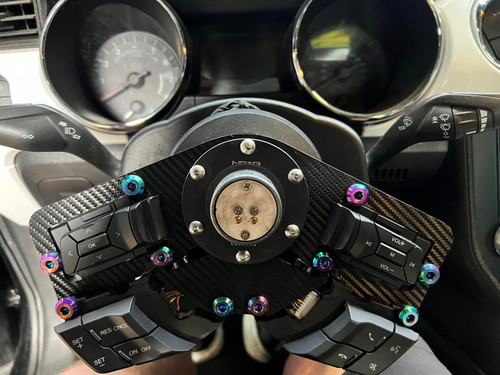

Steering wheel buttons rewire to aftermarket button pad.

That bracket is mounted to the wheel hub. So it’s not removable with the wheel, but does turn with the wheel. My long legs wanted the extra room to get in and out of the car (one of the reasons I went with a QR wheel).
I only needed the two switch groups. And didn’t like the off balance look of the two right hand mounted switch groups.
Again - asinine I know…..

Can confirm what others have said - the steering is communicating over the CAN network. As evident by the MMR module, you can remove the buttons and transmit the appropriate codes over CAN to retain the functionality. Would have to use a CAN sniffer to figure out what is being sent to which IDs. Pretty tedious process to document it all. Big reason MMR is charging so much such a cheap part. but that's pretty standard from them.

I wanted to drop an update here for anyone going down this road. There is a way forward on this that is more involved than relocating the button pads, but way less involved than some of the possible routes or suggestions we talked about in the thread.
Last week I had the car at Texas Track Works in Fort Worth. Mason, who is by all accounts their special project guru took a look at it and, came up with a solution which sounds so simple.
After he looked at the wiring diagrams, and tested jumping button contacts with external buttons, he came up with a plan by using the internal PCB’s from the oem button pads.
I’m still using the deconstructed clock spring, rerouted under the dash, but now I have a bracket mounted by the shifter. Wired from the original PCBs from the steering wheel button I have a little joystick as directional buttons and red momentary as the PONY button.

Very cool. Given the S550 is more complex in its buttons, that gives a lot of hope to us S197 guys
