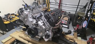

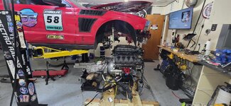

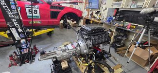

Hey Everyone this is Grant from Spectro Racing. LOOONG time Mustang track & autocross guy. Below is the build thread with some goals and objectives.
Car was a 3v with R2300 for most of its life however June of 2025 the oil pump failed at Gingerman and seized the motor.
I had been running Gridlife Track Battle Street Mod Class for the last 2 years. I have about 10 years of track experience and 12 years of autocross.
The goal for the new setup is to reach top 5 in Street Mod, this is whats called the Podium Sprint. Beyond that i know this car is not super competitive but its a hoot to drive and the Time Attack series gives me a good framework.

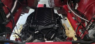

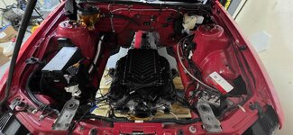

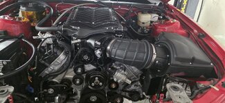

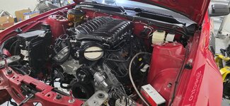

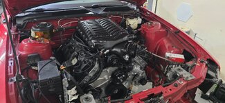

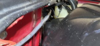

Lots of connections and stuff. One more big bulk buy and a few more weekends and i should be ready to start it. The 11-14 airbox for the whipple does not fit great on a 05-09. I had to chop it up a bit and bend some of the ABS lines out of the way. It does look pretty stock though. It does smush a bit when you close the hood, but it does close. I think ill eventually get a CF hood as i think those have a bit more clearance.
Did hit a setback though. My pinion flange is different than what it should be. I think when i had a shop install the Ford Racing driveshaft 13 years ago they put in the Cobra flange as it was a 4 bolt. So ill have to redo that which means like a solid weekend checking the splotch patterns and stuff if i cant get the pinion bolt exactly where it was.

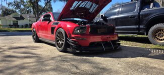

Get a 07-09 GT-500 hood or like me the entire front end.
Clearance, heat extraction and much improved aerodynamics

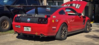

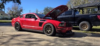

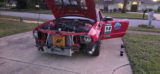

Thanks! So i have the stock hood but gt4 track spec vents and I made my own custom grill. I will need a new bumper at some point though so thats a good idea though. Here is a pic from cmp earlier this year.
OK so lots of work later I got it running. Fwiw you cannot use SCT hardware/software on a pats delete swap. It gives you error 110d8. Which is voltage but is bogus. That took 2 weeks to figure out. We had to use hp tuners. Something with the new sct firmware and sct does not like you rolling it back due to epa laws.
Had the tuner come to the house. We got it about 95% perfect but according to him it has a small vacuum leak or something that is acting like one somewhere. Did a smoke test but could not find anything except im a moron and forgot to put the dip stick back in after topping off oil after first start since it has the oil cooler. Any ideas if its passing leak test?
Still need to test under boost with the tuner next week. But changed the oil and now that it runs, solidifying a few things like wiring and such. After the next running session will go to a dyno for final testing. That will likely be the new year.
In the mean time im installing a haltech ic7 obd2 and verifying a few more things. I had to swap out the diff pinion as my old one was slightly to short and from an f150 not s197. Happy to report though the tremec magnum xl swap went well and installing the bleeder screw on the throwout line meant no pumping endlessly. I did also finally separate the reservoirs too.

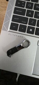

Haha indeed, here is my adhoc tool I made. Aka just cut a wrench

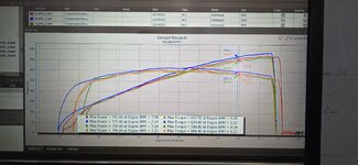

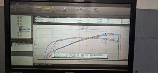

Ok so after many issues later i hope i am on the up and up. I did get it dyno'd and set the car at 750whp/604wtq at 14psi on a 3.75 griptech. Which is 1 psi less than my 4.6 and 120 more HP. One run it did make 775whp. This is on VP X85, which is just really pure e85.

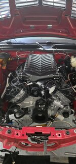

Also then had to remove the supercharger for the 2nd time as i smelled fuel vapor. Nothing was leaking but didnt chance it and ordered professionally made lines from Raceflux vs the ones i made since now i knew the exact length i needed. Vapor smell went away and Fuel regulator seems to like the new lines better and acts more normal.

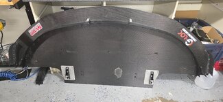

While waiting on the custom wiring i built a removable splitter from Professional Awesome(removable brackets), AJ Hartman(the splitter, which i had but the spring loaded rods) and Racebred components (the dam). After talking to @AJ Hartman who both of us go to Gridlife together he mentioned getting his splitter as low as possible. I have a Futura trailer but i still think ill have to remove it. With the 19s its 3.1 inches off the ground. The 18s will sit an inch lower due to the tire being less relative sidewall too 35vs30.
One open problem i still have is the Whipple belt tensioner seems to oscilate up and down alot more than normal when idling. I need to have someone look at it under load to see if its a problem.

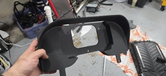

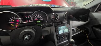

Lastly i ordered a Haltech IC7 as they are on sale. I still have a stock 11-14 ecu but you can run these off of OBD2 and also add in oil pressure gauges and what not. The dash insert i ordered from Australia though from makomotorsport tho was terrible. it bolted up but the haltech didnt fit in it with out custom spacers. It also looked shitty with the retro removed as it sat really far back. I didnt take any photos as i was filled with rage i waited 2 months for that lol. There is another one from a different company that sells 11-14 that just replaces the entire left side of the dash so may do that swap.
I did then move it to the center console as the real purpose is just alerts for IAT2/Coolant/etc. I made my own digital gauges based on my cars real gauges in photoshop and will sell this eventually on our website.

I don't understand the highlighted comment. Are you building it knowing you won't be able to keep it cool, or are you saying screw the theory, I am going to make it work?
In post #9, I see the intercooler at the bottom, a bronze colored oil cooler, and the radiator. Where do you get a triple pass radiator? What does "ducted in the rear" mean?
