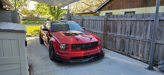

Alright, some final prep. I am hopefully "done". Beyond probably maintenance stuff. I did take it to a track day and proceeded to immediately destroy the splitter by missing a braking zone because the car was way faster lol. Somehow i just smashed the rods and supports and AJ's CF splitter held together. Other than that car seemed fine at the track day just way fast lol. Didnt really record anything as it was a shitty day as my futura trailer also ran into issues but their warranty support is superb.
Final things was hooking up the Haltech Oil Pressure sensor and configuring it. Car is running stock ECU, so im using the OBD connector for the IC7 and i wired in this TI 150 gauge. There was limited instructions on how to do this if anyone needs help. Seems to work nicely and i have warning lights now! Left the old one in for reference. The old one is on the oil cooling open side of the tstat.

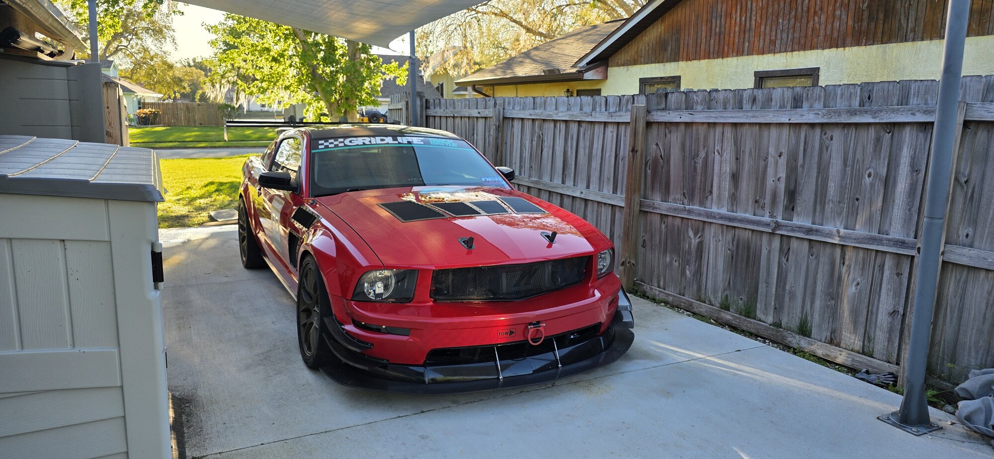

Before the track day i had the tuner come by and retune the car on the 3.85 griptech pulley(vs 3.75). It wont affect much of anything since timing was so conservative but it runs about 12.5-13 psi of boost vs 14. So should run cooler.
Also putting on the Apex SM10RS Forged 18x10s, along with 285/30/18s RE71Rs. I went with that aspect to get it super low per AJ's recommendation. They are ~8lbs lighter ea than the equivalent tire on my 19x10 APEX flow formed. So for double the price it probably isnt worth it.
The Splitter is now set at 2.75 on the front and closer to 3ish on the wings. The plates on the rods are a bandaid after smashing the old rods through the splitter. So i really need a new splitter but this works.
Have one more autocross and maybe a track day before the first gridlife event, but probably just the autocross.
