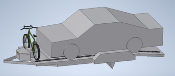

After renting and borrowing for the last year or so, I finally decided to buy a car trailer. I picked up this 18ft trailer from a fellow racer last week. This one came with an E-Track system, straps, Race Ramps, winch, and so on. On that list of projects for the trailer is a rack to mount my bicycle and possibly a rock guard to protect the front of my car and/or bike.
Below is a CAD model that I'm using to check fitment:
Bike Rack Requirements:
  • Must mount in front of the car
  • Must not require the removal of any bike wheels
  • Must have room clearance for my winch below the crankset
  • The ability to be mounted with the E-Track system and removed when not needed is optional
Does anybody on here have anything similar on their trailer that I could use for inspiration? Thanks in advance.
Many folks have a shield with diamond plate at the front of the trailer and that would be perfect to also mount your bike behind. It would protect the front end of your car from rocks, etc. when traveling and should be easy to attack some supports to the back to tie up your bicycle.
