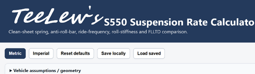

S550 Setup Calculator
Trying it out now, its really cool, and I need to learn about FLLTD. I have used an excel that's similar in function for years, mainly to give me a front roll stiffness % to target setups around.

FLLTD is Front Lateral Load Transfer Distribution. It takes sprung and unsprung load transfer into account. These are all static values, but it gives us a way to describe all these combinations in a quantitative way to describe a combo as opposed to in the touchy-feely way we've been doing it forever. You can put your individual car's corner weights in if you wish. The unsprung masses are estimated. Those need to be actually measured.

This is pretty interesting. Is there anything other than the drop downs that make this S550 specific?
The metric/imperial buttons only seem to change the anti-roll bar input units and all of the output units. Is it possible to change vehicle assumptions/geometry to also change with those buttons? I know could introduce more room for error/bug
It's written to be as S550 specific as I can make it. I've made all sorts of assumptions, so it won't be perfect. There are no actual suspension geometries involved. Most good racing springs are #/in (at least in the US), so I left them in imperial units.
