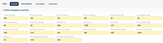

It's written to be as S550 specific as I can make it. I've made all sorts of assumptions, so it won't be perfect. There are no actual suspension geometries involved. Most good racing springs are #/in (at least in the US), so I left them in imperial units.
Click on this. I think it will be what you're looking for if you want to tailor the numbers to your car. A live rear car is going to be a little different in how it produces ride/roll rates, but you can tune it for the S550/650 variants.
I meant is the vehicle assumptions/geometry inputs not able to follow the metric and imperial button selection? I can convert everything. I just didn't know if this was a bug or has to be metric inputs?
Ah, OK....that's just something I didn't think of. Don't tell anyone, but I tend to work in those 'funny' units.
When I get back to it, I'll add that. If anyone else has some features or things to add/change/whatever, I'd be happy to work on improving it.

Yea it's funny I use metric at work but home I use imperial. Option for no anti rollbar would be nice as well, at least for the rear.
