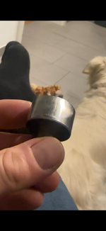

Hey everyone, I'm running a Mustang Mach 1 on track. After a complete vehicle rebuild I'm currently dealing with a temperature issue: oil temperature climbs quickly to over 155C (311F). During testing I noticed my oil cooler stays cold though – consistently around 24C (75F). This obviously means no oil is flowing through the cooler. Can anyone give me tips on what might be causing this – thermostat or bypass valve?
(little digits in the display are the max values)
thanks for any help.
