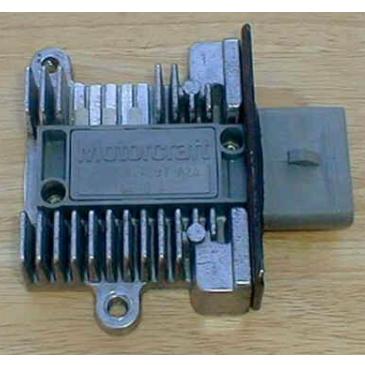

The way Ford solved the TFI heat failure issues was to mount it off the dist. on a alum heatsink on inner fender using a harness running back to the Dist. I think this was found on some P/U's and Explorers or 5.0 T birds. I think there was also a aftermarket kit but its been years since I messes with this setup. Looked like this

Found this from my past files. LMR may still have a kit. This was common in Rangers, Aerostar's , T birds ect. Salvage yard may still be best bet to find
