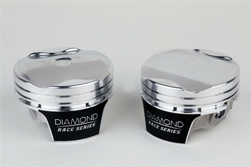

Looks like Diamond has a 3.650 piston off the shelves.
