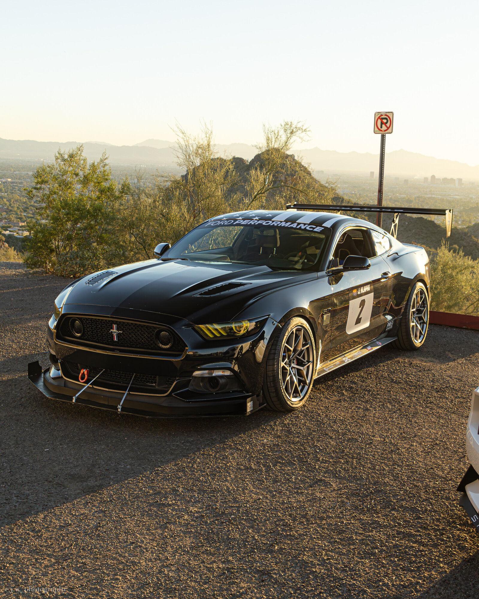

Summer work is 95% done, just need to change the axle fluid and flush the brakes before we get back out on Labor Day weekend. New splitter made from ACM instead of wood, headliner and curtain airbags out, most of the interior trim and carpets gone. Setup changes I made were going from a 670lb front spring to a 550lb/in spring, and stiffening up the front sway bar, as well as going from the OEM rear sway bar to the BMR one.
Last time the car was weighed in the winter I had no passenger seat and it was 3950lbs, as of now its down to 3879lbs with an OMP passenger seat. Both weights with me (280lbs) inside. I also got more camber on the front and rear (-3.5/-2.25) and lessened the toe out in front and toe in rear to hopefully help life of the new Hoosier R8 tires a little.
