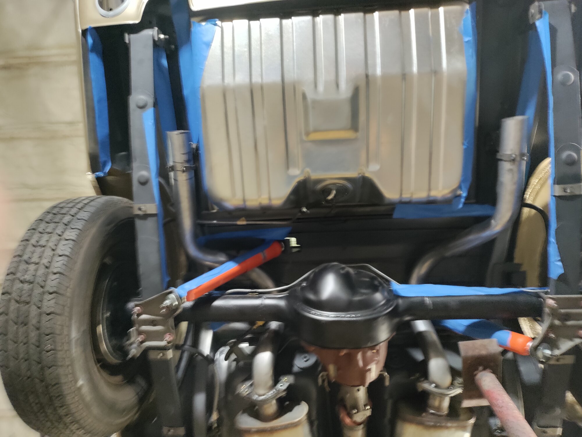

Rear is in and she's standing on all 4's again !

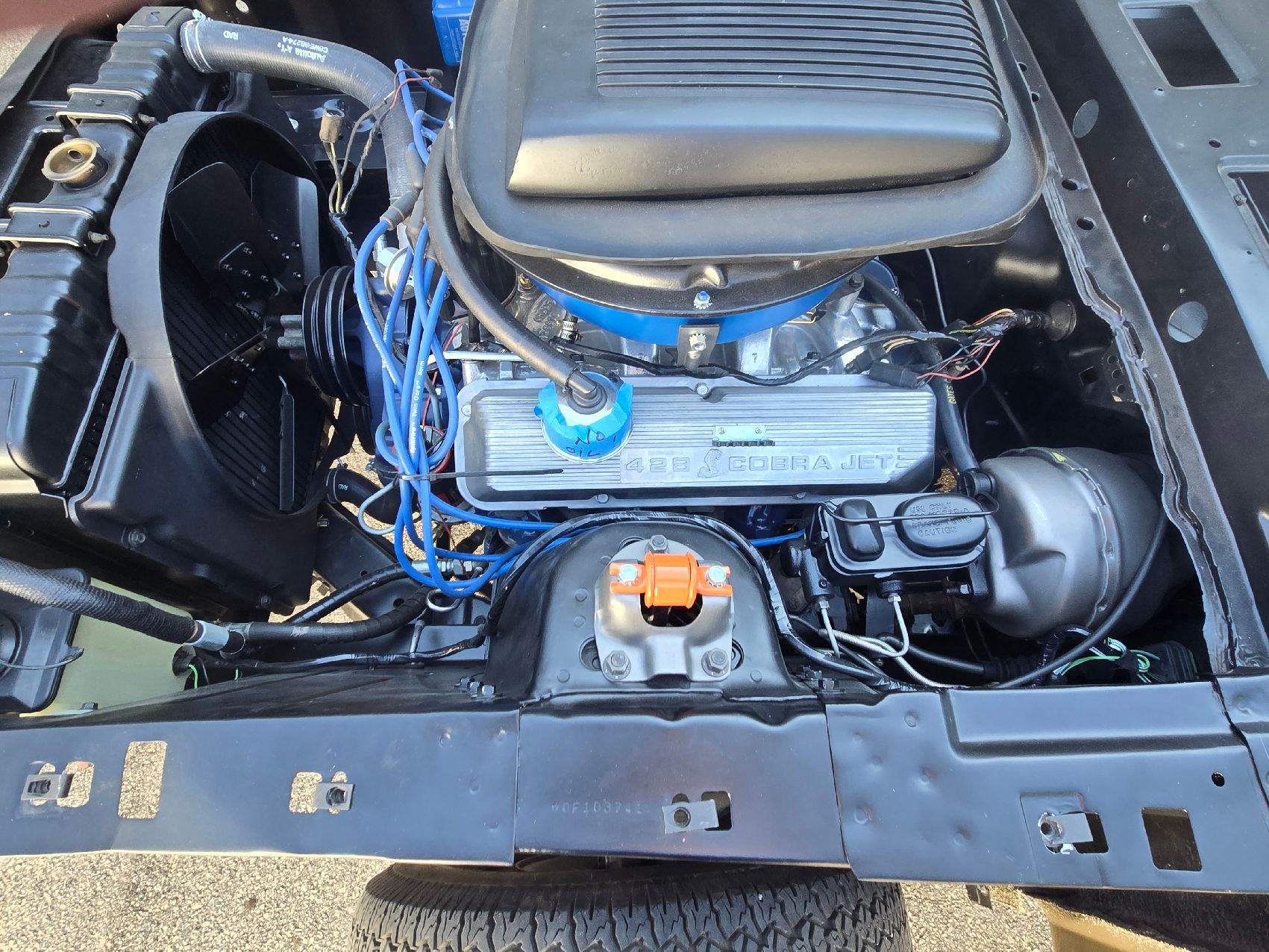

Engine is T'd up for install - just need to bolt on the clutch & bell along with the exhaust manifolds.
After that its time to dive into wiring and brake/fuel lines....yay

I recently started to resume some activities and today, with some help from my brother and a good friend, the engine was finally installed in the car.
It's a relatively small step forward but felt really good to just see it set in place. It dropped in as smooth as anyone could hope for, FPA headers and all.
No clearance issues anywhere and we didn't even scratch the paint in the engine bay.

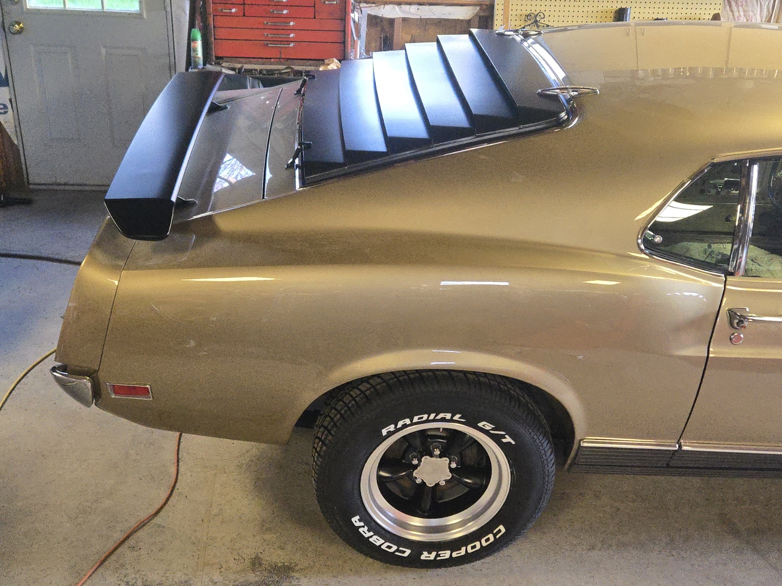

Nice choice on the wheels - they look very period-correct. I bet it rides smoother over highway joints than the rubber band tires on modern cars. You can always slap on a set of 18s if you want crisp turn-in on track.
