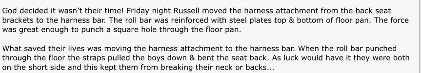

It’s only as strong as the sheet metal you attach it to.
...I set up a quick simulation in Autodesk Fusion and was able to see if an impact force was applied that the plate would start bending, and where the sheet metal would tear away from the bolts.
I haven't yet been able to find the best way to replicate a nutsert...
There's a lot of different failure modes to consider depending on the nature of the event triggering a failure. The fastened joint may be exposed to tension loads, compression loads, shear loads, or a combination of these.
...A nut cert has crap for pullout in sheet metal...
A fastened joint is only as good as it's weakest member. Even a grade 8 bolted joint will fail under relatively low load if attached to thin sheet metal. The plate in the nut plate is to distribute forces over a much larger area, like a reinforcing grommet on a sheet of binder paper.
That's why you need a back up plate.
The small amount of engagement that a nutsert has on the back will pull out of sheet metal at very low loading, especially when you figure the main hoop as a fulcrum.
When you see images like that it scares the hell out of you. Makes me think back to the old days when I ran fixed seats with harness belts and NO rollbar or cage. I know people still do that, but I can't help looking back and feeling like I was extremely fortunate I never rolled and tested my luck. Running cars on a track is dangerous, we all know that. Anything you can do to make it as safe as possible in the rollbar/roll cage department is money well spent. Even then you never know what could happen.
