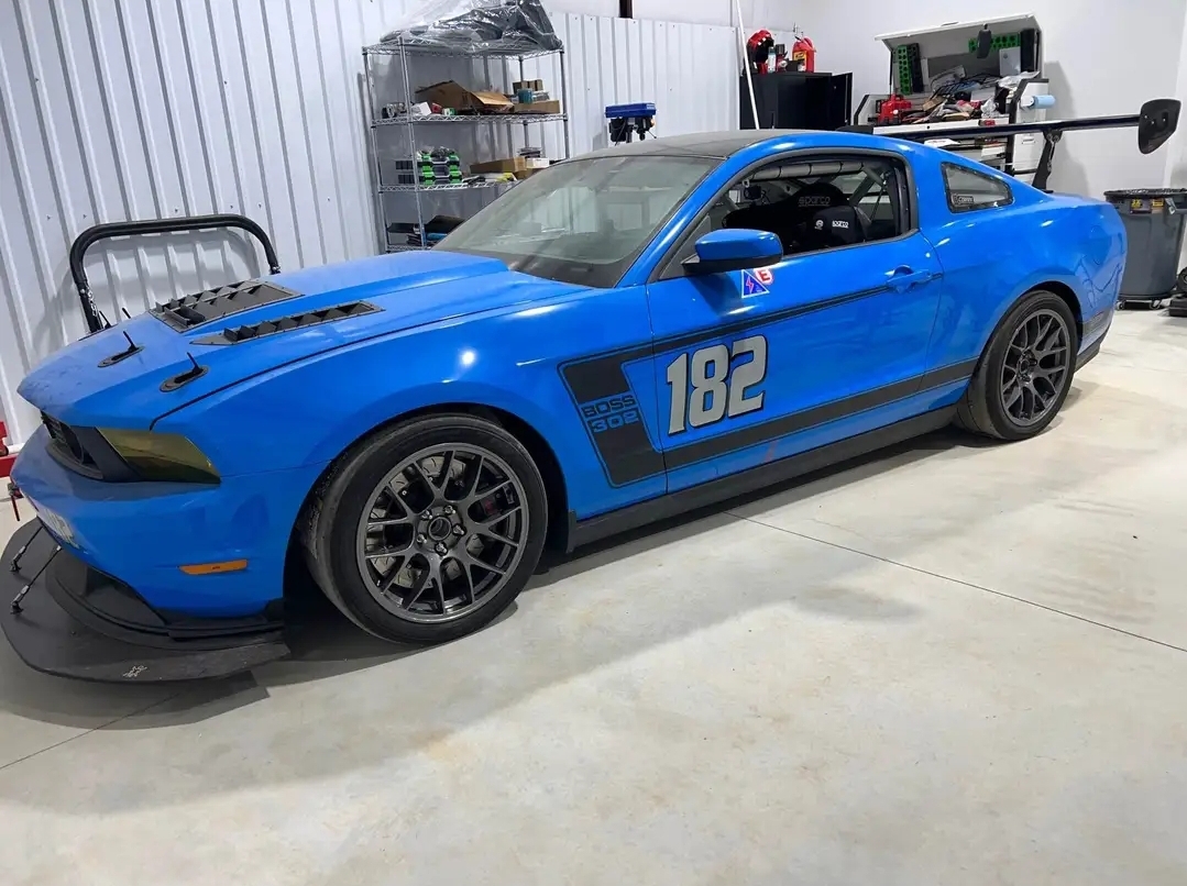

2012 Boss 302S Clone
Finally... dyno tuned a week ago. 100F day with high humidity - 467hp @ 7430rpm, 373lb-ft @ 5450rpm

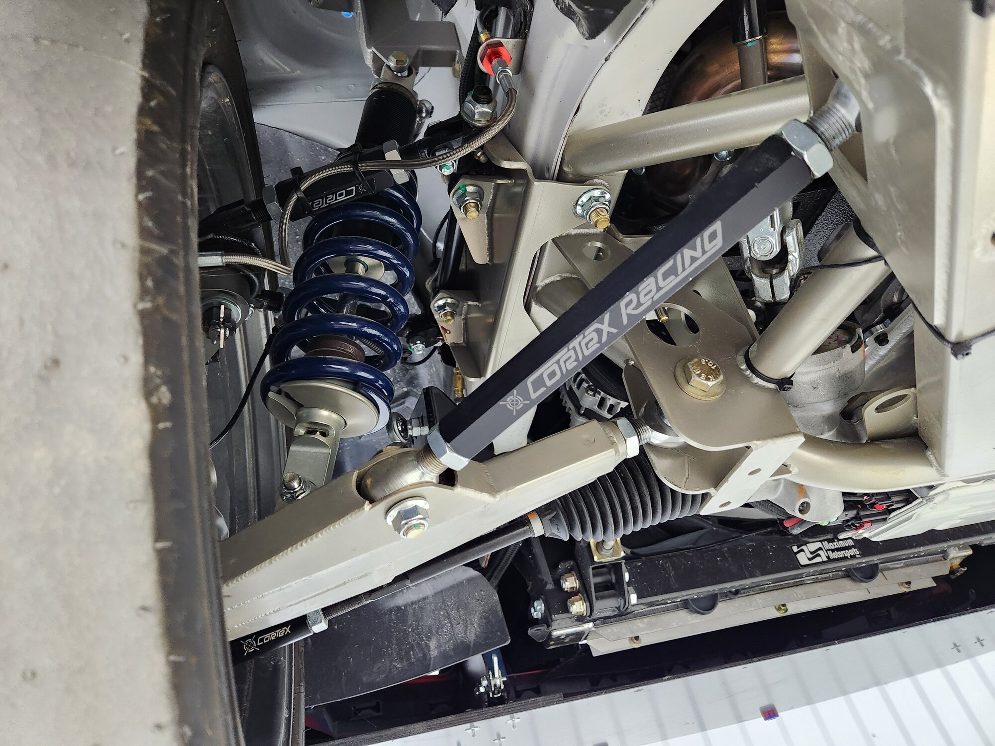

Working on the alignment today with Cortex SLA front end:
-3.25 camber
+8 caster
0 toe
I assume the SLA doesn't need as much static camber, but I can't find any recommended specs. This seems to be good enough as a baseline.
