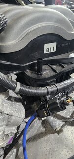

I honestly don't see a line on this engine that looks like it belongs there.
I have one smooth fitting on the rear of the intake manifold that has nothing on it. Different type of connector though. It appears to be maybe a half inch in diameter.
I purchased this as a pallet engine and it was running fine.
The Coyote EVAP purge solenoid (and the line that connects to it) is at the front of the intake manifold, on the snout behind the throttle body right next to the fuel rail crossover.
Yep, it appears I need an evap purge hard line from the throttle body to the connection behind the strut tower next to the fuel line connector.
The port at the purge valve has a shipping plug in it from Cleveland Performance. I'm just missing the line.
The nipple on the rear of the intake manifold is a dummy from what I just read.
