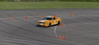

Sorry I missed this thread. You will be fine on RE71's and will want at least 3.5 camber. Photo is my car with 295's and 4.1 static camber. Seemed to be decently competitive at Nat's.

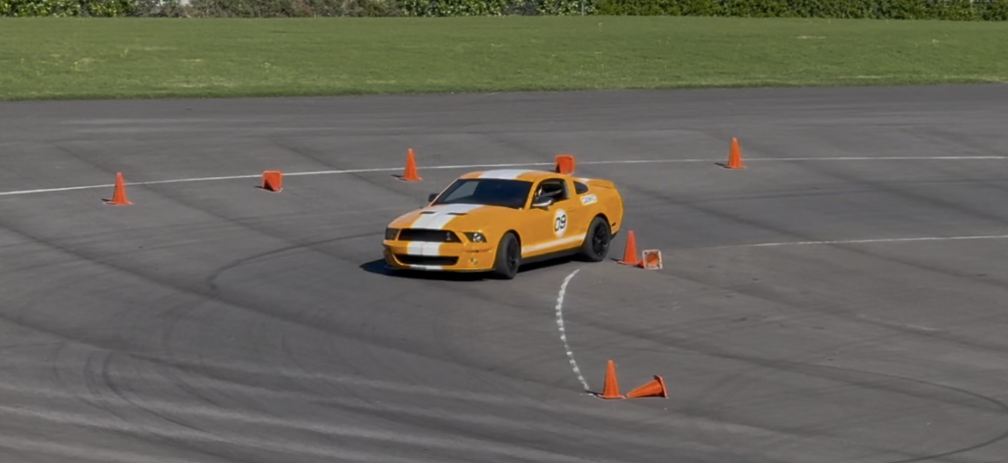

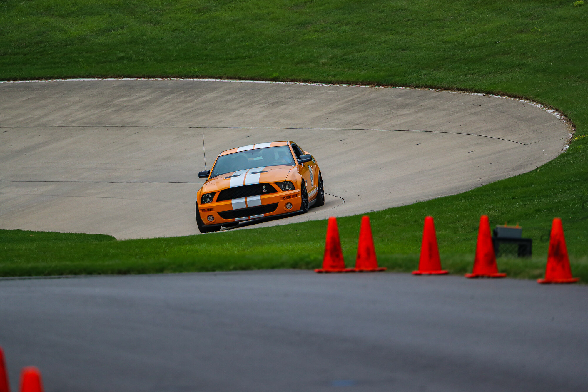

For event was an overall success!! Car handles much better. Turn in is way better with tons of front end grip. Had a fair amount of oversteer so still some setup work to be done. Anyone in Alabama area who is a suspension genius who wants to offer guidance let me know!
Which hole is the watts link in?
If top hole is 1 and bottom is 4 then I was in number 2. I was going to move it down 3. Thoughts?
Exactly, second hole up will tighten the car up.
(I always refer to the bottom hole as 1 and the top hole as 4)

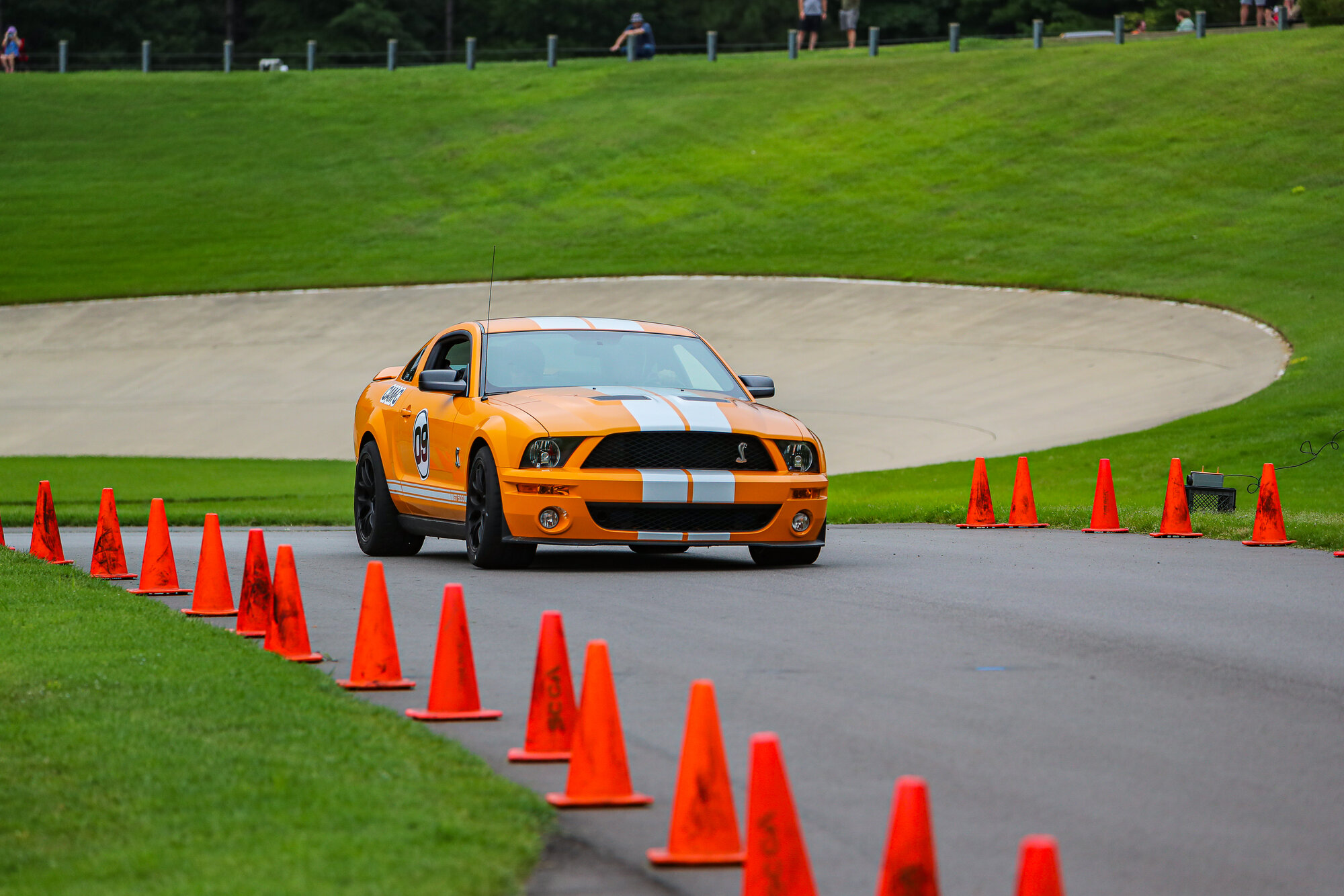

Is that the facility at Barber? Haven't been before but looks like a great place for an autocross course. I would love to make it over but that would probably have to be a pump gas trip as I don't think there's enough E85 along the way to drive the car over and back without a trailer.
Yes it is Barber, we run on the proving ground and it is an awesome track! You should come at some point. Where are you coming from? I can let you know some places to get e85 I have some friends that run it. By the way love your car!
