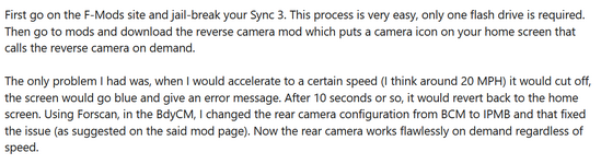

Referenced here about half way down the page. I have no idea if it works, i'm just good at finding crap on the internet.
There were mentions it was hard coded as part of a safety function so couldn't be just changed, hence why it appears the unit needs to be jail broken so custom software can be loaded.

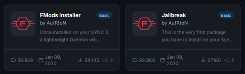

Steps appear to be Jailbreak the Sync unit, upload some mods, change some settings in forscan.
Looks like alot of risky programming, I will stick to the mirrors. thanks.
