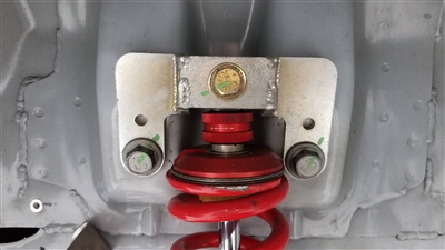

First, I started monkeying around with my camber plates up front to add some more camber and I ran into two problems. On the driverside, I went to loosen one of the nuts and it just snapped off. I'm fairly confident that this wasn't from over torquing since I use a torque wrench every time, but could be wrong. Either way, that sucks.
I thought no biggie, I guess I'll have to get new camber plates. Went to the other side and found that the top nut had come loose and the play inside screwed up the tolerances. The stud on the top of the strut is all chewed up (not pictured) and the camber plate is about 1/16" wider diameter than it should be. So it looks like at least the passenger side front strut is toast and given their age, it's time to retire them. I've started talks with Cortex about a set of coilovers (hence my other thread :). Hopefully can get those ordered soon.

The first plates I had were MM. A bolt snapped off on installation, which was done with a torque wrench at their torque level. When I reported it they were less than friendly and straight up blamed me. They eventually did send a new piece, though I had to pay shipping, duty, tax, etc.
Replaced them with Vorshlags which have been trouble free and got me to -4 vs -2.2 for the MM pieces. I gave the MM pieces away to a guy for free. Figured that's what they were worth.
Ya. I had a few people recommend them based on their experience with Foxes, but it seems the overall quality of aftermarket parts for Mustangs have been increasing as companies like SPL, Cortex, Griggs, etc. evolve and put out their CNC goodies.
I think the new coilovers come with a Cortex-specific camber plate, but I'll grab Vorshlag if not.

Looking at the Watson website, I'd suggest that if you're going to go to coilovers, that you look at their rear top mounts and, in particular, their front camber adjusters:
Ya, I posted about those now being available in the general forum. I'm definitely eyeing the Watson camber plates. Those shims would simplify things a lot.
