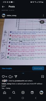

I always found this curious in your case. We found that the headers always gives us a consistent power gain of around 25hp in all the coyotes. The shop I use must have done about 20 cars. Most of them gen 3's with 3" custom exhaust, CAI, headers and E85 (no cats), puts the Gen3 cars consistently at between 495 and 505 rwhp.
I think is basically the same concept. With headers you expand gasses right away more than oem. With cat back you do that 3 ft after.
So this was the dyno. Keep in mind this was full OEM. And unfortunately done in 5th gear.(9whp) We did a conversion for 7th gear and was 12-14
I don't remember how cause it was in 2019 lol
MY theory is once u increase tube size the effect is the same of the headers.
In other words whatever u increase first will
Give u the hp peak gain.
I feel that its a little more complicated then just size of the exhaust pipe. Here is a video we made with some X pipes. The top one is a custom one my guys made up, the middle is a Borla X pipe and the bottom one is a Kooks X pipe. You can see the suction gained with a properly made X pipe, and we did the same with the merge collector on the headers as well.
What was a pretty big shock to me was that the Kooks X pipes had no extraction at all. As for headers, our Ebay US$250 coyote header with a custom merge collector added to the end, performed much better then the expensive Kooks setup I had before. Many name brand headers, Like Borla, have no collector at all. I dont see what the gains would be from a system like that.
