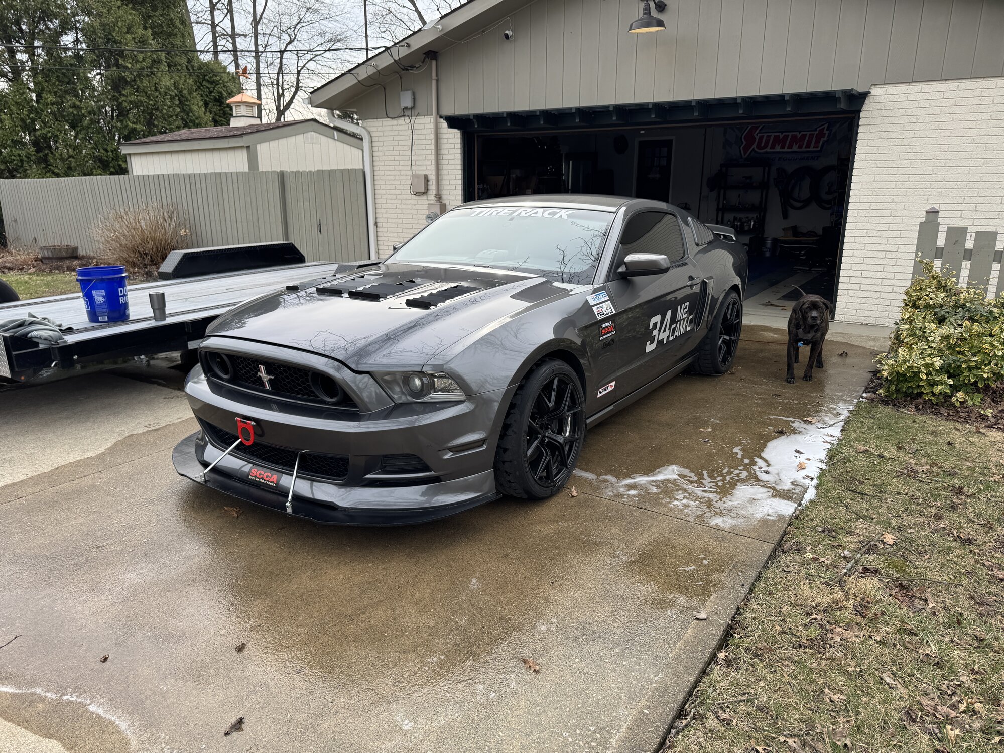

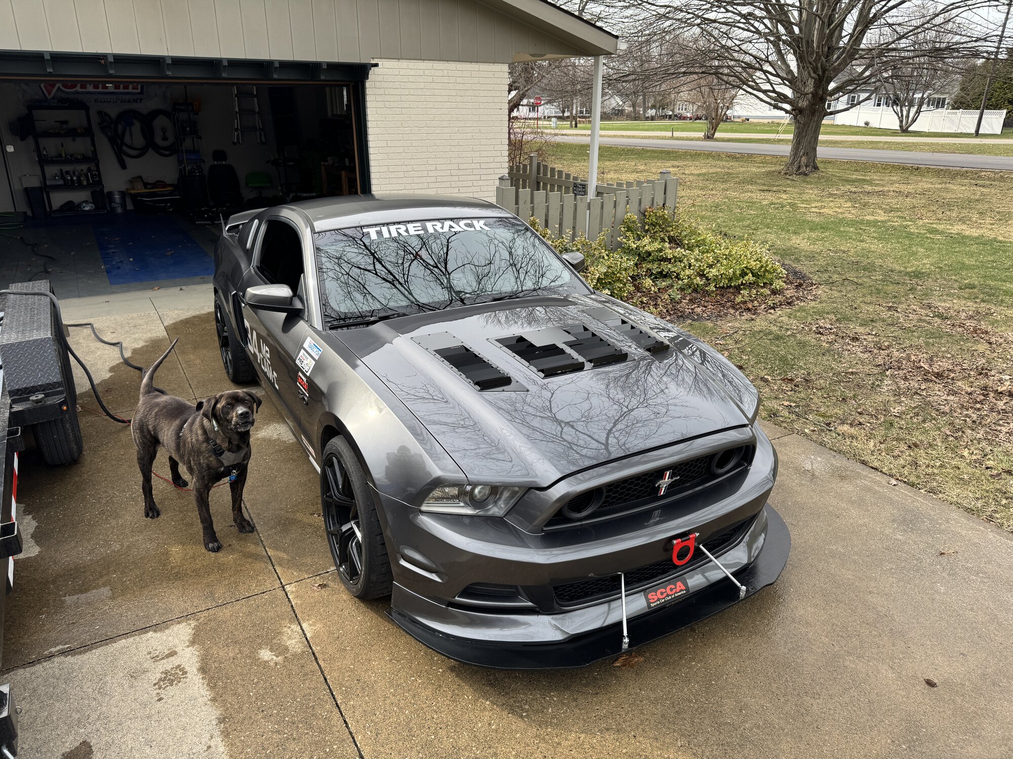

A little update from this winter's shenanigans.
As stated above, my main goal was to install an oil cooler for the anticipated track days and Time Trials that I want to do this year. I went with a Setrab 934 heat exchanger, Setrab thermostatic sandwich plate, spacer (for gauge sensors), and -12AN hoses and fittings. The exchanger was reasonably easy to mount; more on that later. The hoses were a pain to run. I ended up going the long way (around the passenger side of the radiator) to avoid sharp bends. The temperature sender is in the spacer plate and reads the engine oil temperature before it goes through the exchanger. The engine oil pressure sender is T'ed into the stock oil pressure sender location, which (I think) is reading pressure after the exchanger and filter.
I went with Autometer Ultra-Lite gauges inside the Ford Performance gauge pod. I opted to mount my pod at an angle so that I could accurately read the gauge from the driver's seat. It looks a little odd but is functional. I'll likely fill the 3rd gauge spot with a wideband or coolant temp sensor, but neither of those is high on my priority list right now. The pressure gauge worked right away but the temperature gauge read very low. Apparently, the spacer that I used wasn't conductive enough, so I had to add a ground to the sender base using a ring terminal and high-temp grommet to keep constant pressure for good contact.
While planning this, I decided that I might as well get 3 birds with one stone and buy the Ford Performance bumper bar. The goal was to provide a lower mount for the oil cooler, add chassis mounts for the splitter rods, and add a tow hook. As a bonus, it helps offset the extra weight added by the oil cooler. The new hole in my bumper cover could have been cut better, but it was a learning process! The bar that I bought didn't come with the tow hook, so I made one that matched the Ford design.
Another small project was to increase the spring rate in my front coilovers. I did have 7 kg/mm (390 lb/in) and swapped them to 12 kg/mm (670 lb/in) springs to better match the 5 kg/mm (280 lb/in) springs in the rear. I'm still using the Pedders dampers, which I've had good luck with, but the internet seems to dislike. I'll keep rocking them until Vorshlag brings back their "Track Pro" setup for S197. I'm loving the spring upgrade so far.
My brakes need a little bit of attention too. The front rotors are wavy (not warped) from the extreme wear of using DTC-60 pads on the street and at autocross for a month or so before I switched back to HPS 5.0s. I will be throwing some new StopTech rotors on and will make sure the swap pads before and after track days. As I was looking at the rear rotors, I noticed that the uneven wear that was mentioned in a post last year is still present. The rear pads seem to be wearing unevenly also, so it's probably time for new rear calipers. New (not remanufactured) OEM rear calipers have been ordered and should be here next week.
I need to redo my numbers to include my time trials class. Unfortunately, the splitter puts me in M2, but everything else on the car seems to fit really well into T2. I don't plan on being super competitive in time trials, so it's not worth taking that on and off to me; autocross is where I want to stay competitive. I removed a lot of the stickers from the car while I was at it. I'd like to have the numbers and class be a little more subtle, but the Sterling Gray paint seems to make numbers without contrasting backgrounds or borders very visible. I'm open to suggestions, but right now I'm planning on doing the same thing that I had but with M2 and CAM-C stacked on top of each other. Looking back, I probably could have kept what I had and used reusable vinyl with M2 to cover the autocross class for time trial events.
Finally, I'm doing routine maintenance. Fresh oil change, transmission fluid, differential fluid, and brake fluid. I've been taking my sweet time, but everything should be good to go before my first event. If the weather looks good, then my first event will be Track Night in America at Nelson Ledges next weekend. Can't wait!
