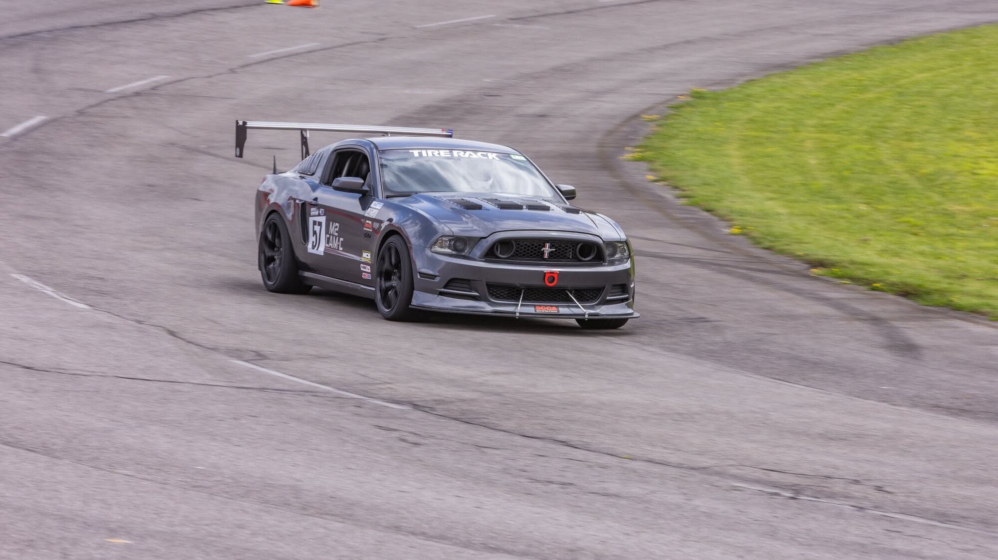

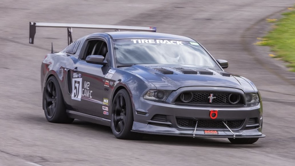

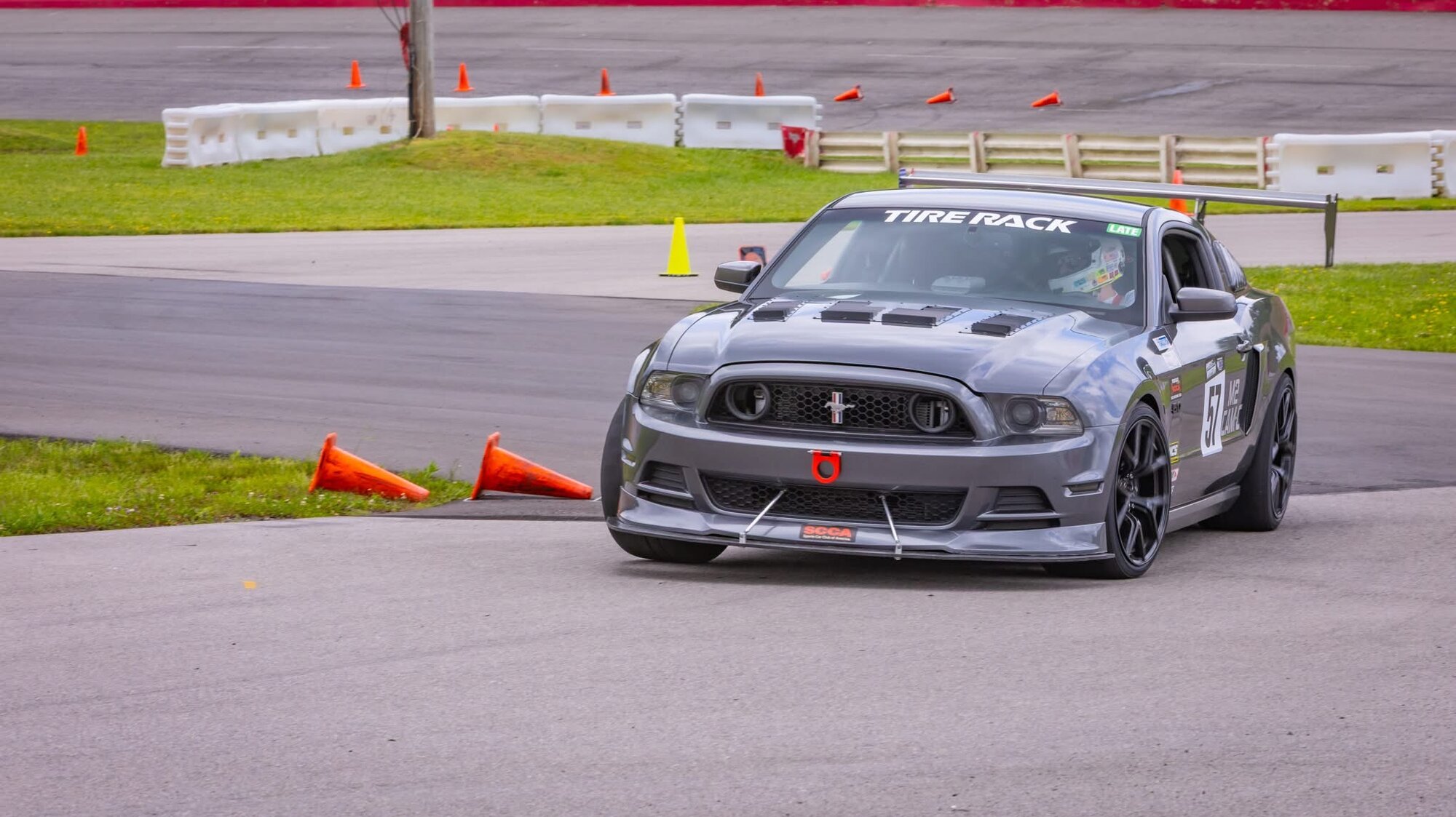

I decided to pull the trigger on a Nine Lives Wing after Watkins Glen. It arrived the night I was putting my car on the trailer for Muscle on the Mountain at UMI Motorsports Park. It was a thrash to get it together that night, but I'm happy with how it turned out! It works great too!
I had the wing set at 5° AOA with a 1/2" gurney and their CFD V2 end plates. I didn't get a chance to wrap the wing before leaving, so it stayed silver for the weekend.
I started by driving as I normally would, with the plan to ease into it and trust the rear more and more as I went. I had not run at this venue before, but the rear of the car seemed much more controlled, and the car was pretty balanced. I never had issues with the front before, but I had a few spots where it pushed after installing the wing.
The car was great all weekend. I ended up being the top qualifier going into the shootout. I was a ding dong and coned away my second shootout run, but won 3rd in the late model class. It was a super fun event!
