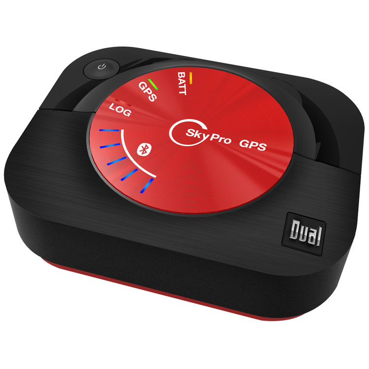

Also tried out a new helmet mounted camera view. Doesn't give the best course view, but much better idea of what I'm doing inside the cabin. Also still having issues with the GoPro maintaining GPS connection so I lose the cool track map overlay as well as the speed monitor it normally provides. Anyone have any advice on this.
That was a really fun season and super glad you joined up! I am looking forward to next year.
For your GPS woes, I use a Dual X160 GPS puck that I place on the dash that uses bluetooth and should hook right up to your GoPro. Mine usually reads accuracy within 5-7 feet and gives a strong signal.
