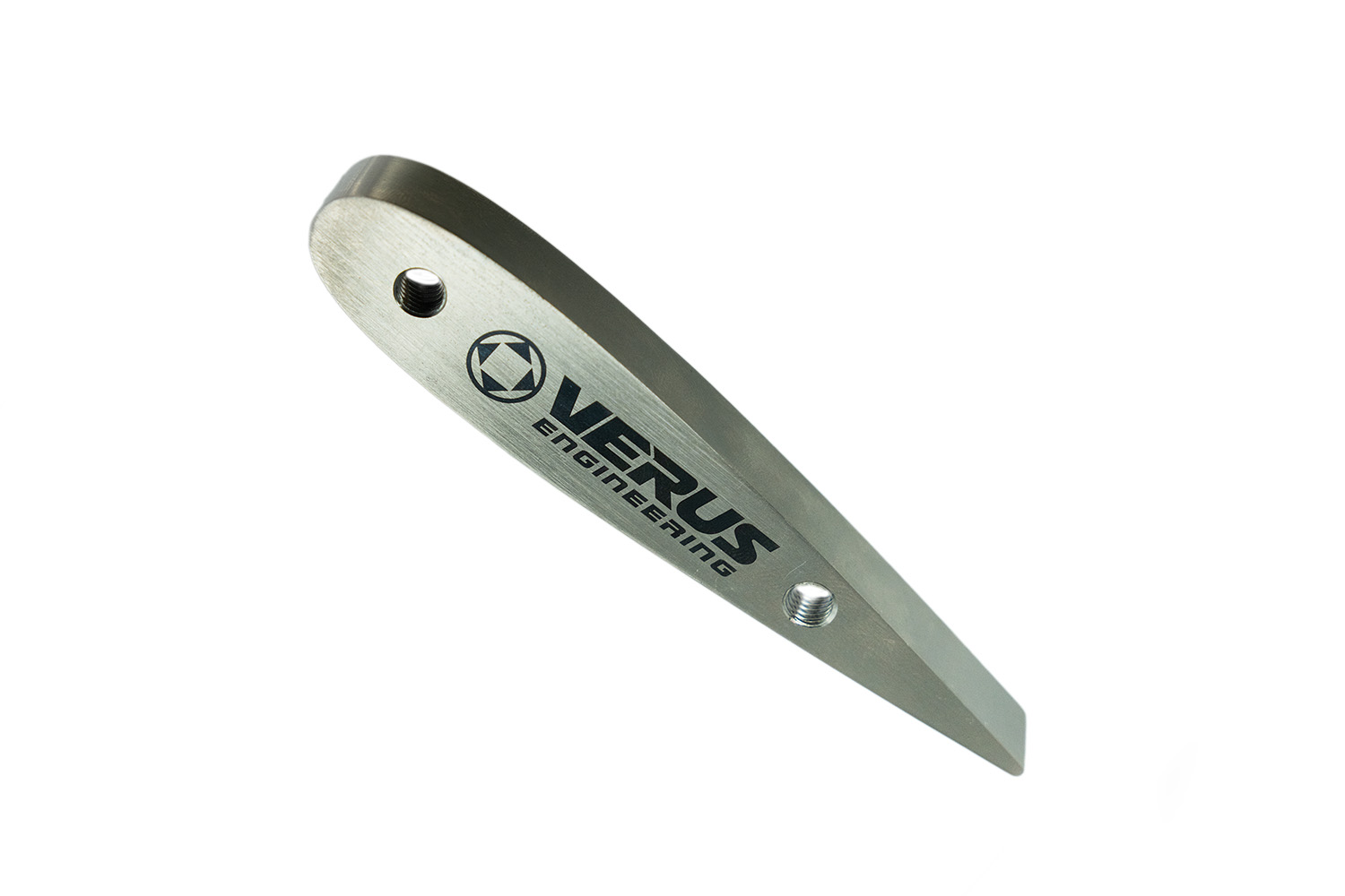

These may work as well.
Currently looking at these. Seems the Titanium would be a little heavier, but also much stronger than the Carbon.
Also looking to get more info on these from AJ as I always like supporting site vendors and members if their products meet my end goals.
