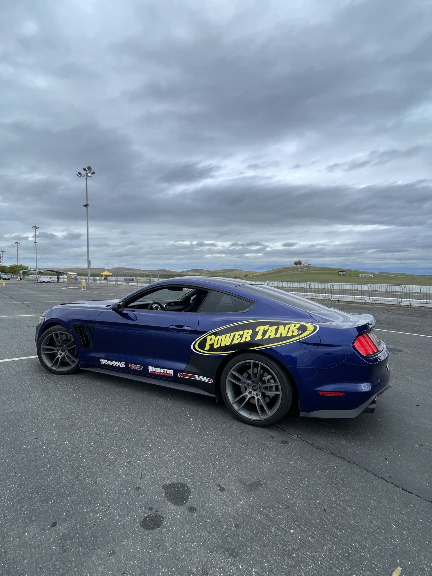

S550 Power Tank's Cobalt Filly Build Thread Profile - S550 Mustangs
Track NASA TT4 Build - A Young Man's Racecar Dream/Midlife Crisis In the Mid 20s

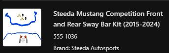

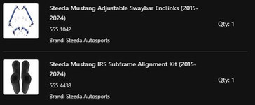

Got the Steeda install done along with many other parts (some from my new friend @1 old racer ).
