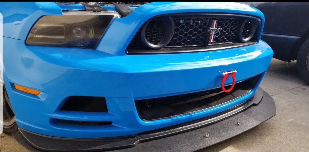

2013 boss 302 grabber blue

That pic looks familiar....
That story I told about my ex learning to drive a stick, her girlfriend taught her to drive one, Sue had a 70 Grabber Blue Boss 302 a beautiful car. I still run into her now and then and she laments the day she let that car go. As I recall she paid about $4500.00 for it in 1981, and it was complaee, 60K mile car.
Thats interesting,I would love a 70 grabber blue boss. This boss has 62k miles on it.
