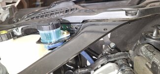

I had one that I bought somewhere as a kit, maybe it was from a newer GTO or something. It constantly splashed/leaked out of the cap and then was almost empty.

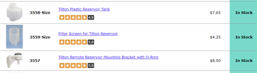

Switched it out for a small tilton remote reservoir and no leaks, works great. I had them laying around, but if you had to buy, it is the top part and bottom one from this screenshot. (and maybe a cap if it doesn't come with the top one)
