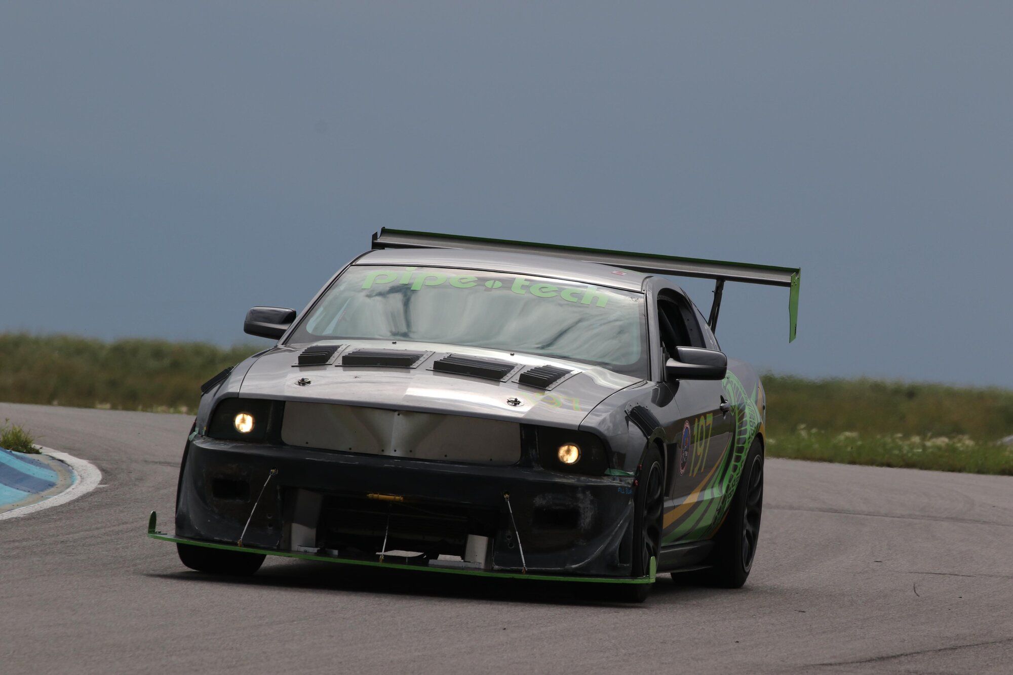

Almost done making tow hooks.The crash bars must be a hardened steel, had a heck of a time drilling through the rear one.
Got super lucky. Paint lids off and was about to mix paint, then the power went on and off a few times before cutting out. Semi rolled and took out the power lines. Timing is everything, that would have been a expensive waste of paint as the booth went dead. It’s going to take hours to get power online. Emergency vehicles everywhere.
First color done ! Decided to paint the rest minus the front bumper tomorrow. I still need to bodywork the bumper and it and it will be on and off lots as I make a quick removable front bumper/splitter. So the bumper will get painted later. Body shop wants their space back. Tow hooks almost done.

I’m going to have more time info fixing the fiberglass/building splitter than anything else on the car ( came caged ). Holy moley, what a huge amount of time. It will be removable no tools and only a couple minutes. I think the ground clearance of splitter will be 4 1/4 inch. That’s a little lower than I wanted. And I only realized that the lower rad opening is much wider than the rad, just makes ducting a little more work :(
