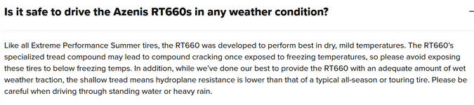

First issue is can they take the cold in general. You be the judge with the below information.
No temp info on the Conti, but you get to see my shortcuts :eek:
