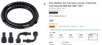

Sure thing! Below is a screen shot of my order from Motion Raceworks with the SKU #s on the right. For the remote catch can filter kit, I bought the filter and mount only. There is an optional 3' hose you can buy, but I opted out for that because it was so expensive and I was not sure how much hose I would need and wanted extra. It looks like I bought two filters, but it says in the description "Note: This kit reuses your Motion Catch Can Filter: Click Here for replacement" So then I added the filter from the link. For the valve cover breather you can add the option for a 12 an orb to 12 an adapter, which is what I did.
The second part of my purchase was the kit below from Amazon. This was mostly for the hose and random fittings that would likely come in handy as I was not sure where I was going to mount the filter.
