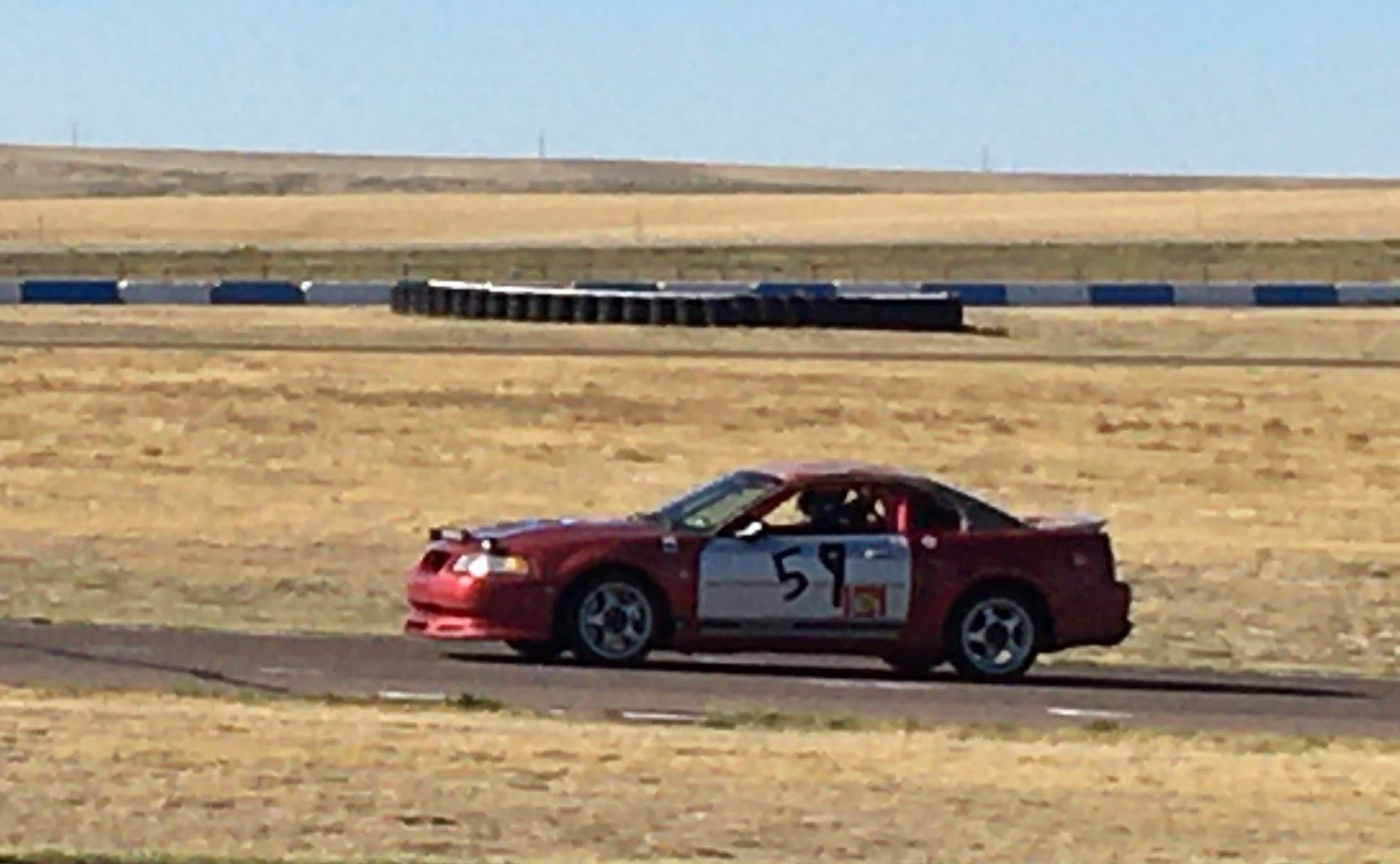

Found some old pictures, realized I hadnt updated this in a while.
Finishing off the 2022 prep
Relocated battery to the trunk and reduced weight by 19.5# using a 9 pound Braille b219 battery.
Boxed in the radiator, moved the overflow tank to where the battery was, added a second transmission cooler.
Added some big wheels I got used. Enkei PF01 18x10.5 with 38 mm offset, 295 Yokohama AO52. Wheel offset larger then I would like but price was right. Compensated with 31mm spacers from opmustang.
Had to add front flares. Used tandem axel trailer fender cut in half. Cut the back half of the front fenders and folded them in.
Weight redux - overall removed 70 pounds

2023
Changed from 3.27 to 3.55 gears. Glad I got the crush sleeve eliminator because I had to re-install the gears a dozen times before I was happy with the pattern.
Added a mesh screen in front of the radiator to protect from rocks.
Gutted fuel neck so we can fuel faster.
Got an 03-04 hood and cut a hole behind the radiator for better venting.
Tried an Aerostar aluminum driveshaft but had the wrong yoke. Was 1/8 inch too thin. I didn't realize it until I was loading on the trailer and all red fluid poured out!
Had decent trouble keeping it running well. Thought it was fuel filter getting clogged but finally realized hitting the governor on the back straight was the issue. After a few times the AFR would go really lean until we restarted.
Burned through what was left of the big tires and had to switch back to the small ones.
Going the wrong way on results but having more fun each year!
