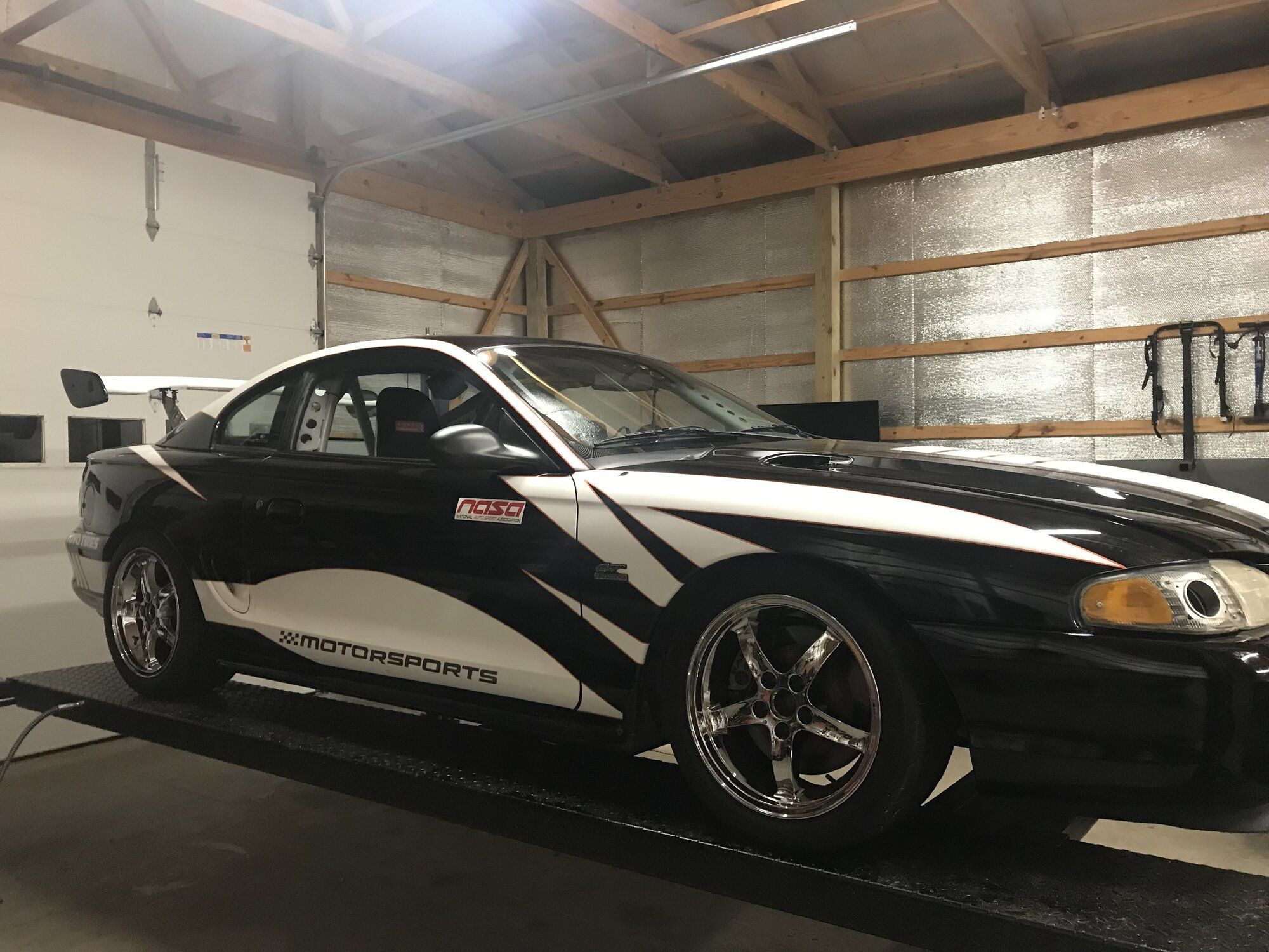

I started taking inventory of the front arms while I wait for the rear parts to arrive. You may be able to tell from the image that the front bushings are mushroomed out. My suspicion is this is due to very hard braking on track. I don‘t know for sure though. I’m thinking of going to Delrin bushings.

while working on the front I noticed the inner tie rods were worn. The rack is great, no leaks or gear slop. You can also see in the image the bent tie rod. Anyone have recommendations on Some Race Quality tie rods?
You don't want "race quality" tie rods, they just transfer shock loads to the rack, every mustang team I've worked for had the same issue so we always kept a box of tie rods lying around. Trust me, you don't want to beef up the tie rods, it just causes headaches elsewhere.
Thanks BS-1. I can find them $17 to $60 online. Do you think there's any difference in quality?
Well, I've always been a Moog fan, but I think even they are having stuff built in china now, so to be honest, as long as they are moog or TRW or some other name brand, you're prolly OK
Initially I thought these arms were in great shape. I could just weld up and re-drill the worn out sway bar hole. But since the Bushings are not available anyway, I’ve taken measurements and ordered new arms with Delrin bushings from MM.
