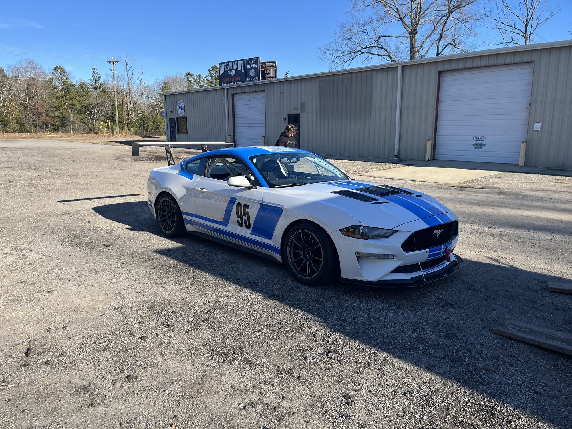

2019 Mustang GT currently doing duty as a TT and HPDE car.
I finally have the issues with the sequential transmission controller fixed, and it appears to functioning properly. Had to send it back 2 times and it was a lot of trouble shooting / testing to get to the bottom of it. Max at Xinnering was great at working with me and getting this fixed.
Up next was solving my exhaust issues, my exhaust was a cobbled together mess of parts from different manufacturers, I have had so many cracks in the system that I had welded back together, even the resonator I put in it to get past noise restrictions at AMP had a 10” crack in the case. My guess is all those products were designed for street use and not 20 min sessions with the car at 5 to 7k RPM’s. I replaced this with a 3” Kooks system, not only was this a much better fit under the car but it sounds really good. Don’t know if I will meet sound requirements at AMP but I will have them test it at the next NASA event.
