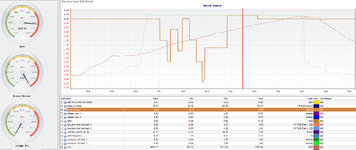

By process of deduction, it seemed that my only remaining culprit was something to do with the engine. Either my cylinder scoring or maybe problems with the valve seals. Even though I am not willing to replace the short block or cylinder heads over this, I wanted to verify the findings. I did a series of WOT pulls using the different configurations I have available. Here are 3 results using the following configurations: SCT 93 octane tune + 93 octane, SCT 91 octane tune + 93 octane, and SCT 91 octane tune + 93 octane + Lucas octane booster.

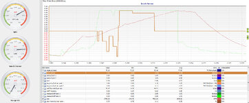

I don't have any proper tunes, so I used what I have at hand. The 93 octane tune is a little more aggressive than the stock tune. They both produced 3 degrees of knock, but the SCT 93 tune sustained that knock for a second longer. Using the SCT 91 tune reduced my knock down to 2 degrees, and adding octane booster eliminated my knock!
At first, I thought that this confirmed a minor engine issue, but I went over this with AI, and the AI says that this is incorrect, and that these logs prove that my engine is working as it is supposed to! The AI says, that if this problem were being caused by an internal issue, that the knock would not be affected by an increase in octane (I would think that this would depend on what the internal issue is...). Which I guess would make it indistinguishable from false knock? The AI says that my most likely culprit is bad gas. I don't like this theory, because I've already tried using gas from several different places and get no change in results. Considering the things I've already done to diagnose, a valve seal problem seems less likely at this point. I never see any blue smoke, and my oil consumption is relatively normal except under sustained (road trip) highway driving. So if oil is getting into my combustion chamber, it seems that it only happens under certain conditions. It also seems less likely that it's blowby. I'd think that if it were blowby that my knock would continue up to 7500 RPM and it never does.
I thought about this, and came up with a new theory. Fortunately, this one won't be hard to test. A while back, I noticed that the inside of my intake manifold was caked with oil and so I installed an FRPP oil separator. This seems to be doing a good job, but I've learned that under WOT, the airflow in the crankcase reverses because there is no vacuum to open the PCV valve. In this case, blowby gasses are expelled via the crankcase breather hose. I would imagine that when the airflow switches directions like this that there is momentarily greater pressure inside the crankcase than normal. What if, when the airflow switches direction, a slight buildup of pressure is pushing a puff of crap into my intake? If this was the case, it would explain why my knock always occurs at about the same RPM in my logs, and why it tends to step down and go away after an initial spike, even though the car is still building RPM. If this is the case, all I need is a simple driver's side catch can!
I went ahead and ordered a kit from Radium and am looking forward to some more tests. For the time being, the 91 SCT tune seems like it's the safest so I left that on the car. Let me know if any of you guys disagree with any of the thinking here. I'm no mechanic! Just doing the best I can.
One thing that I think that I can rule out completely though, is false knock. So my noisy transmission is good to go!

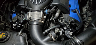

Radium driver's side catch can installed. I got this kit because it looks high quality and it's the only one that has a very nice custom bracket to mount it instead of a generic deal that you have to mess around with to use. The filter system seems top quality and I like that it has a system that bypasses the can in case the can fills up. As for the cons -- it's quite expensive. But you get what you pay for... I hope... The driver's side bracket is very cool and seems solid, but it's a tight fit. The bracket rests up against the OEM airbox which made me worry about rattling/false knock, so I put a small piece of dynomat on the side of it. When the can is installed, it makes it much more difficult to remove the breather hose and therefore the intake hose. The short rubber hose that runs from the can to the intake hose is so stiff that I have to remove the AN fitting instead of the OEM quick connect side in order to remove the intake hose.
Took it for a test drive to ensure no problems/noises, etc. and everything looks good. Will show some pictures after I get the passenger side installed and after that it's datalog time again.
As a side note, while I was installing this thing I put a flashlight inside of my intake hose and gave it a thorough inspection for signs of oil. I hadn't noticed any before, but this time I saw it. Streaks of oil stretching out from where the breather hose connects. Light and hard to see. I stuck my finger into the port where the breather hose connects and did get some oil on my finger. Then I flipped the hose upside down to see if any oil had made it into the Helmholtz resonator chamber (the reservoir on the OEM tube) and sure enough there was a tiny bit of oil in there. Just a couple drops. This theory is looking up. But why does my car like to spit oil out of the breather hose? I haven't noticed many other people having this problem... Fingers crossed...

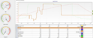

I think I did it. With nothing else left to try, I went back to the bad gas theory. I didn't have much hope because everything I've tried around here has been about the same. Earlier this week I went to a Shell station I haven't tried before and yesterday I dropped a fat log. This is Shell 93 with the SCT 93 canned tune and my new dual Radium catch can setup (which could also be helping). I did have a .5 degree spike at about 5K RPM, but I think tuners will find this acceptable...?
Gonna try getting a Lund tune and see what happens. Still... I wonder why this weird spike in the middle every time?
I noticed something else too... Even though I have the RPM limiter set to the stock 7500, all of the canned SCT tunes let me rev it out to 8K RPM. On the stock tune it cuts off right at 7500. I guess I'll have to set the rev limiter to 7k with the SCT canned tunes?
