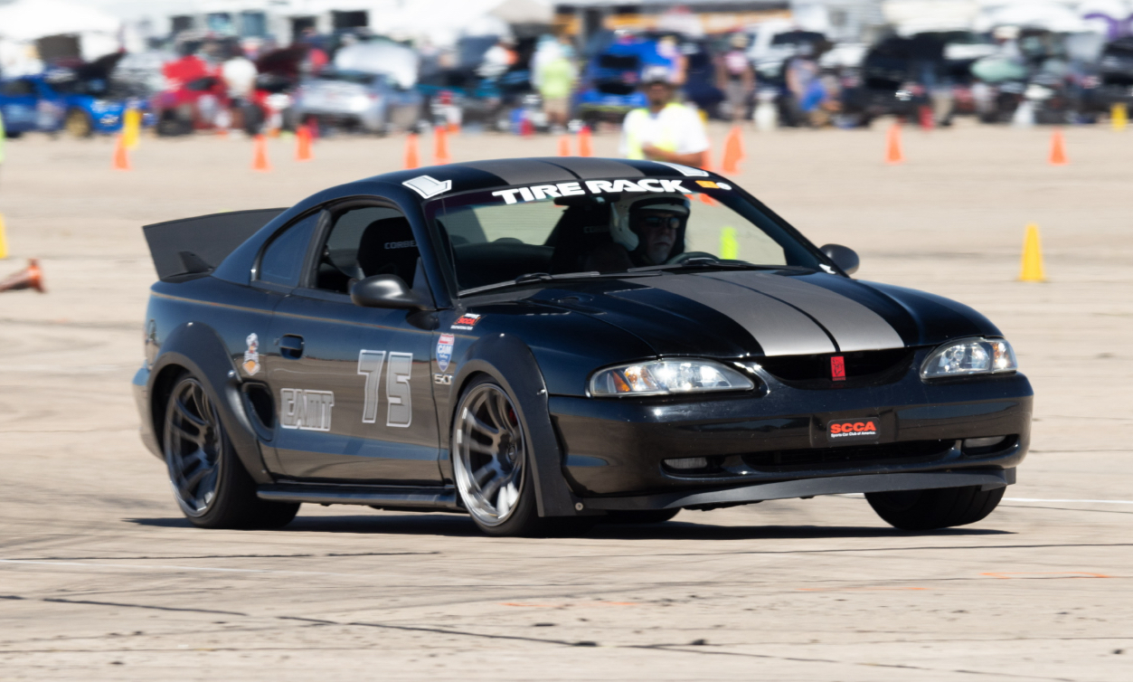

The car’s starting to come together. We made it to Peru and back with no issues, and Michael trophied in CAMT with zero suspension tuning before our first runs. Two of three heats were wet, and the car was surprisingly good in the wet. Probably more due to the A052 tires, which really liked the damp, cool weather.
Attended a couple local events last weekend, and ran into a couple issues:
-The trunk-mounted battery box came loose on day one. Did a temporary fix and ordered a more sturdy long-term solution.
-the monster 35mm solid front bar on the car proved too stiff for tighter courses. It’s also not adjustable, so we had to run some fairly extreme shock & tire pressure settings to get the car rotating properly. Installing an adjustable Kenny Brown bar tomorrow, which should help balance the car out better.
