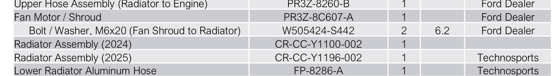

I can see the grill in the photos. I see the tech bulletin on drilling holes in the shroud. The bulletin on the radiator, however, does not specify which one? When I visit PWR, the one it lists for S650 is not a dual pass design, but a single pass.
Which radiator is used, and how much fabrication is involved in installing it? I already read the bulletin on the radiator hoses.
CR-CC-Y1100-002 this is the part number listed in the homologation document: https://www.fordracing.com/content/...lenge/pdfs/2025 DHR BOM Homologation v4.2.pdf

CR-CC-Y1100-002 this is the part number listed in the homologation document: https://www.fordracing.com/content/dam/fordPerformance/motorsport/mustang-challenge/pdfs/2025 DHR BOM Homologation v4.2.pdf

Thank you for posting what you found, but I cannot find that part number anywhere at PWR (note also there is a different part number for 2025 - CR-CC-Y1196-002. The part number you posted is for 2024). I also cannot find that part number or anything else at the source listed, Technosports.
There is a picture of it on page 18 (both it and the 2024 version). Note the inlet and outlet both on the right hand side. I do not see anything like that in the PWR catalog.
