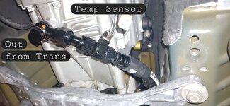

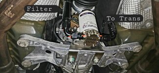

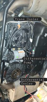

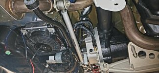

Over a year ago I started installing all the components for my differential & transmission cooler. I couldn't fit 2 pumps and 2 fan packs in the back, so the transmission pump had to find another home. My solution? I fabricated a mounting bracket to attach to the transmission mount and have routed and secured all the hoses.
I now have fully serviced diff and trans fluid in closed systems, I still need to wire up relays and switches for the pumps and fans, and sending units to the temp gauges. That to be revisited later.

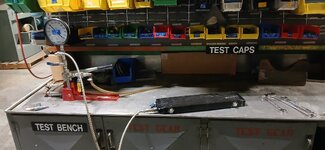

Another casualty of my 'incident' was my oil cooler. I've had it sitting on a shelf ever since, assuming that I need a replacement. It had about a 30 degree twist between the left and right side tanks and one of the AN nipples was kinda bent too. With nothing more to lose, I clamped one side tank between blocks of wood in my shop press, clamped a 6ft long 2 x 4 to the other tank, and just laid into it. it straightened out almost perfectly! I've bench tested it to 200PSI and no leaks so I think with a few passes of a cooling fin comb, It'll be good to go!?

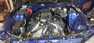

Yesterday I connected battery power for the first time... No smoke, no fire!!!! just the expected dashboard lit up like a Christmas tree... followed by a successful no-start engine crank to verify starter and prime oil & water pump. My motivation is now alive and well!!
And today, I know the engine and associated systems are too!:

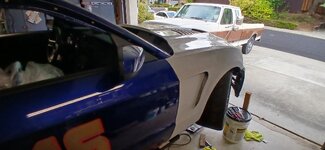

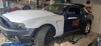

Now that the suspension and everything else on the bottom of the car is virtually complete, and the engine shows life, I've moved on to some bodywork... well, lots of it!
I dusted off a pair of Truefiber fenders I bought a couple of years ago. I didn't like the sharp angular vent corners so much:
So I laminated plies of fiberglass to make radius fillers for the corners :
After bonding them in place and a little body filler... customized custom fenders!

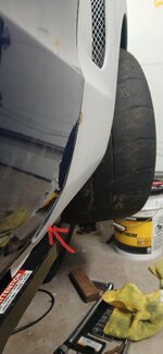

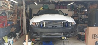

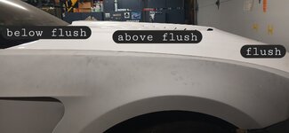

Now the process of aligning the fenders, hood, bumper, headlights etc
These aftermarket parts don't fit perfectly sp I've got a bit more work ahead.
